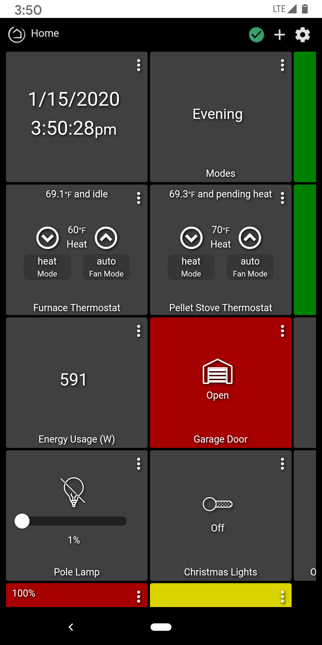

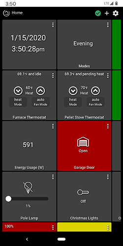

I'm using a Centralite Pearl thermostat with the Generic Zigbee Thermostat handler to control my pellet stove. I happened to look yesterday (remotely) at my dashboard (attached screenshot) and instead of saying "Heating", it says "pending heat". I waited until I got home to verify it actually was heating and it was.
It seems like a recent change somewhere has caused this issue and I'm just now seeing it. It actually put me in a panic at first. I'm almost certain it read "Heating" before. Maybe I'm just crazy.

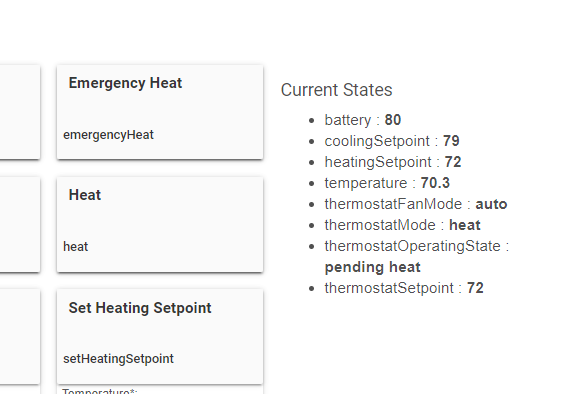

Take Dashboard out of the picture for a second: does the device page itself (under Devices on the left, then click into the page for your thermostat) show the same information? It's quite likely that it does--Dashboard should just receive and display this information. But knowing where the issue is would help determine whether there's a device/driver or app/Dashboard problem.

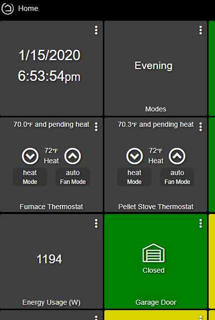

Hey Robert, good question. I set both thermostats to come on for heat (both Pearl's) and checked their device pages. I'm seeing the same modes there as well. Any Ideas? Thanks, -Joel
device-1
Mode is boxed in Red. Operating State in Blue. You're looking at the operating state, the mode is in between the buttons.
When the operating state changes to Heating, the tile will say heating for the operating state.
Thanks Ryan, operating state is what I was after (my first clue is in my own picture). I updated the thread title.... :no_mouth:
Yes it is. Your operating state is pending heat. That's why it's displaying pending heat.
There is nothing wrong with the dashboard.
This:
Matches this:
So, the dashboard is fine.
Also, you can only say this is the wrong state for your thermostat if it is actively heating while displaying Pending Heat. Usually pending heat means that it is not actively heating but will soon.

Yes, and to be clear both furnaces are heating when they are called to (so that's good). Thanks!
