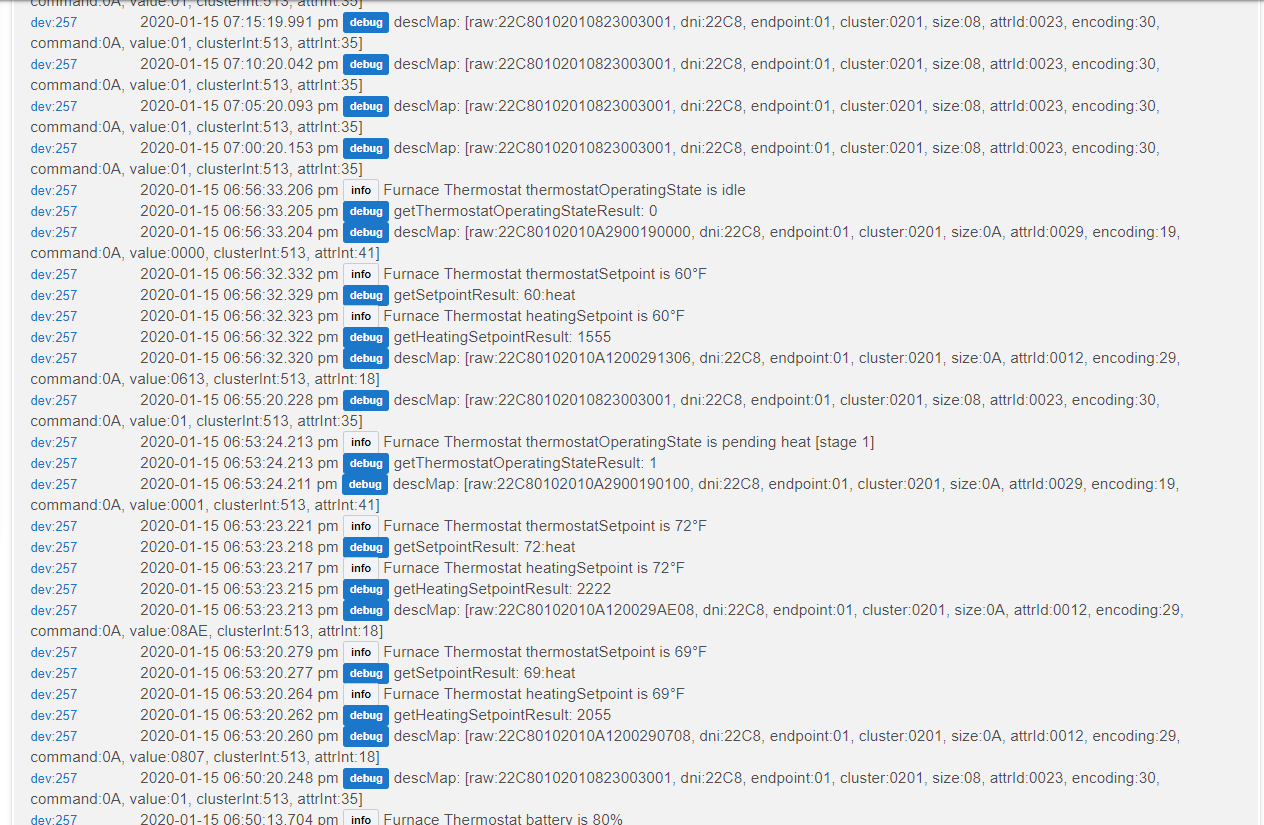

I understand perfectly what you wrote above about the system in evac mode. I can create this condition if I turn the stat up, down then up again. But that's not what is happening. From a cold start, the furnace goes to evac then to full heat but never changes the state to heat.
it won't be heat. It will be heating. Can you show your events listing from the edit device page? You're saying it goes directly from idle to pending heat to idle again?
Yes, I meant to say heating. I'm not sure if this is what you are asking for. This is when I turned up the thermostat to get the screen shot for the first pic.
BTW, I will change the pellet stove to "electric" in the settings when I get a chance. It needs to be in the "off" state and it's currently in use (thanks for the heads up).
.If you go into the edit device page, there is a button at the top labeled events. If you go into that, you will be able to see all the changes for the different attributes. It is much easier to look at that than a log if you're just looking to see what happened to operating state.
This is a perfect example. Your thermostat is pending heat.
You chagne the setpoint to 60,
so it goes to itdle, canceling the heating cycle.
That is exactly what should happen. What i asked was, are you seeing that the thermostat is reporting pending heat when the blower and the burner are on?
