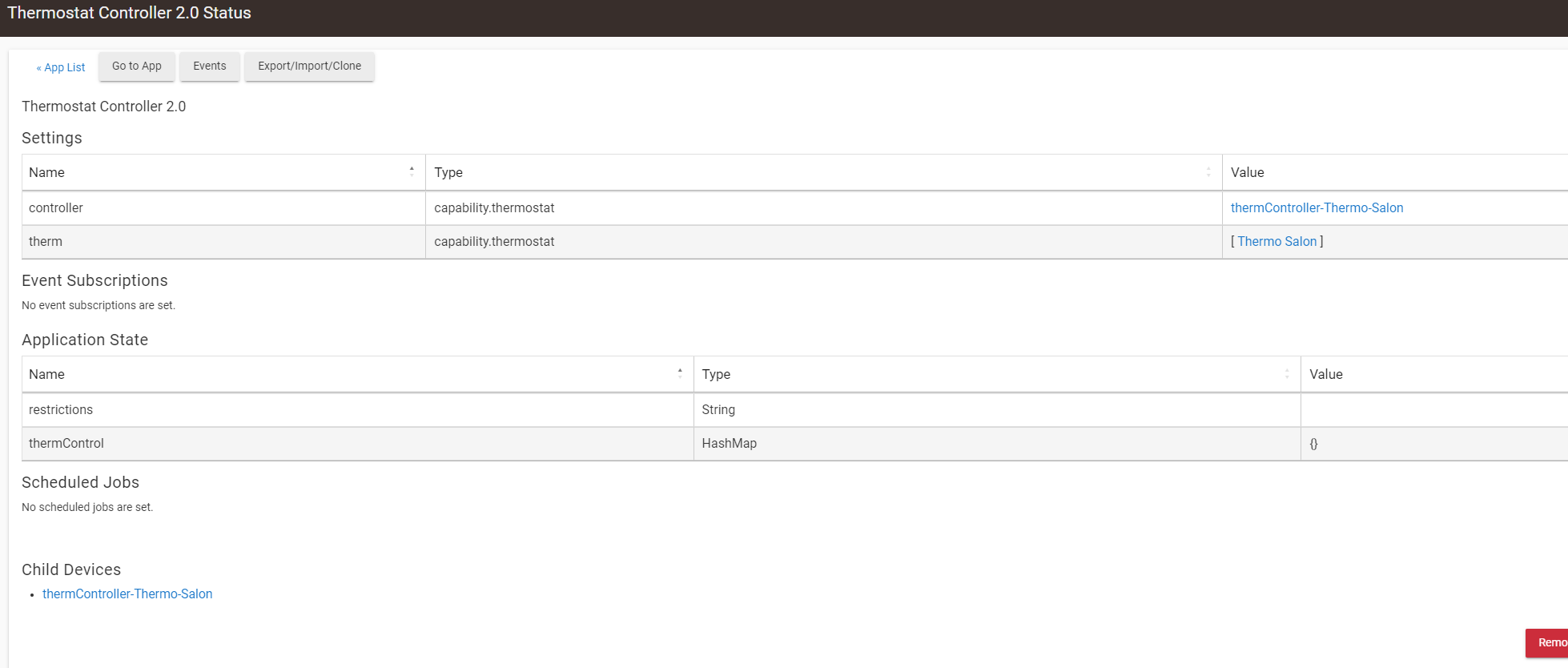

Please click on the gear icon to the left of the Thermostat Controller 2.0 you showed, and post that page here.
I have the feeling that "Thermostat Controller App" was not removed. When I reinstalled it was very fast.
I attach the versions of both. Is it the right versions?
