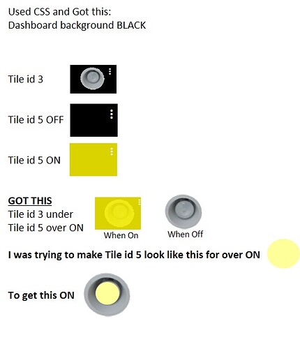

Tile id 3 image only
Tile id 5 device tile
What I was trying to do with my first-time using CSS:

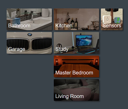

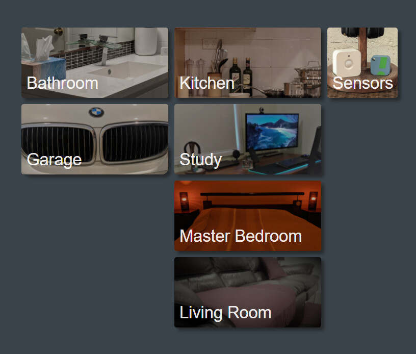

Not sure if tile shadows is something that has been covered before, but something I discovered earlier today....
#tile-5, #tile-9, #tile-13, #tile-16, #tile-19, #tile-22, #tile-29 {
  box-shadow: 5px 5px 5px #26292C;
As always, there a more options to keep us interested....
I use this on nearly everything. Makes a very subtle but dimensional difference.
I agree, I'm not one for big, bold statements (with my dashboards), it's interesting how the smallest things just make things seem right.
