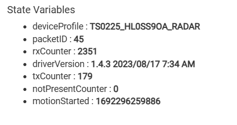

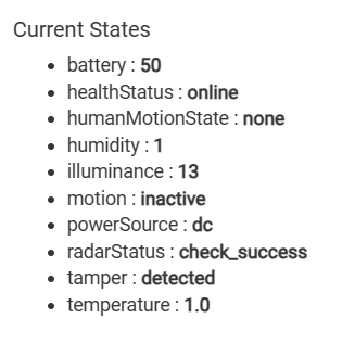

@kkossev I updated to the 1.4.3 version of the driver earlier, and the device is now showing a few extra (erroneous) attributes under Current States. Now showing battery (50), Humidity (1), and tamper (detected).
These weren't here before - still using device profile TS0225_HL0SS9OA_RADAR
An error that has crept in with recent updates or are these supposed to be here? Thanks :blush:

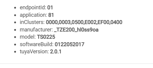

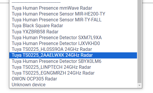

Is your device exactly the same model/manufacturer?
(Check in the Device Details - Data section)
If you have the square shaped 24Ghz radar (from @iEnam link), there is a new device profile for it :
The driver is still not ready for this 24GHz device, it is similar but not the same as the first one.
Click on the Initialize button and see what profile is selected automatically by the driver.
Yes it is - I previously provided the debug logs to you to fix the illuminance reporting issue. New attributes appeared between driver version 1.4.1 and 1.4.3
Device
Variables
States
Thank you for the report, I will be looking for a possible issue here.... My device (same manufacturer) is still working as expected.
I will also add some code to clear the current states when you click on Initialize button, so that there is no need to go to the inbuilt Device driver to do it.
The above fake temperature, tamper, humidity, etc.. states can appear if you accidentally set a Device Profile for a PIR 4-in-1 device.

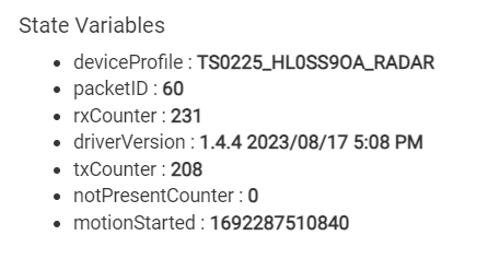

@jason12 If you update to the latest version 1.4.4 2023/08/17 11:39 PM and hit the Initialize button, all the fake current states should be cleared (all preferences will have their default values too!)
@iEnam, the decoding (only) of the preferences for the second TS0225 device _TZE200_2aaelwxk should be OK now. Note that changing the preferences is not ready for this manufacturer yet.

@kkossev - Thanks, that has done the trick.
I also had 4 x Square Version arrive today ( TS0225_2AAELWXK_RADAR) and can confirm they are pairing/working also.
Device profile confirmed as TS0225_2AAELWXK_RADAR and driver version 1.4.4 2023/08/18 2:44 PM
EDIT: Ahh I see you have been 'tweaking' - this 1.4.4 version is later than the one you reference in the post :grinning: can confirm working, and preferences showing.
