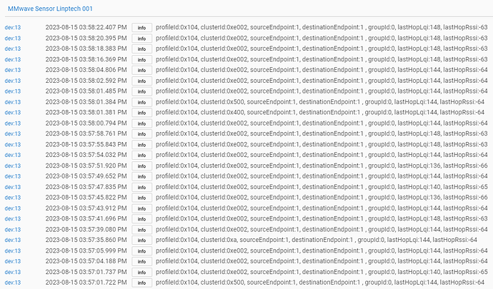

This Linptech Presence Sensor ES1 seems interesting as a form-factor, but I am afraid it will be the same spammy device as the older TS0601 models. The video from your link does not reveal a lot of the configuration options, except that in the radar main page shows 'Distance' - this is exactly what makes these devices spammy and no one is using for any automnations.

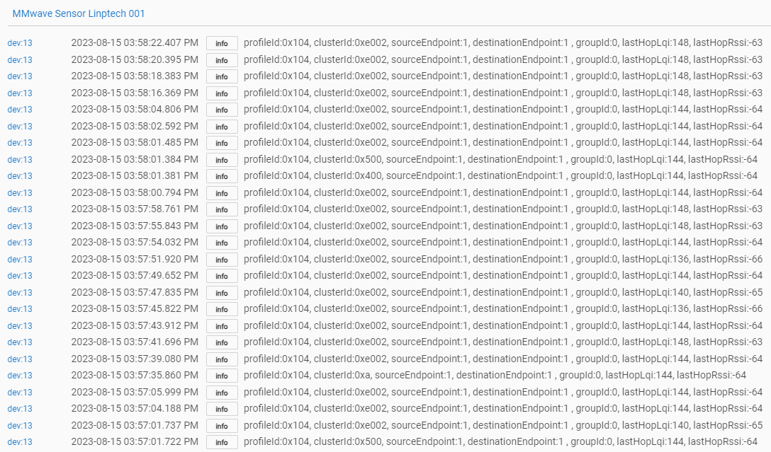

"Spammy" means this :
The Tuya 4-in-1 driver hides all this traffic from the logs.
But it is sent over the air and can be seen from the Settings->Zigbee->Zigbee Logs
Yes. Like the form factor, but it's sending a lot of traffic.

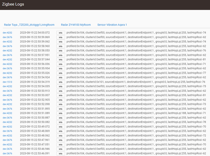

Sometimes I wonder if we are exaggerating the effect of this traffic on the Zigbee network...
There are many thousands of these spammy devices operating, without major complains that they 'kill' the hubs .
No, this is not a lot of traffic if compared to the old TS0601 model radars!
If you stay still, and if the illuminance doesn't change - I suppose the reporting will be much less frequent? Not every 1 second?

The Linptech ES1 presence sensor seems to generate a similar traffic volume as the 'non spammy _TZE200_hl0ss9oa '.... definitely not every second! Compare this and this screenshot.

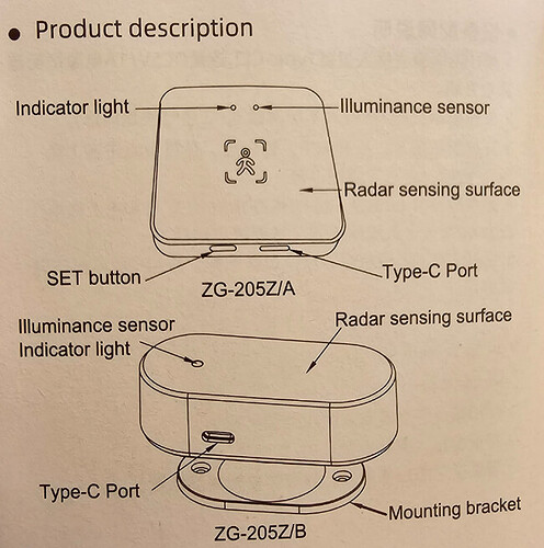

@kkossev, received the sensor today.
Please add the signature when you can - thanks for the support as always!
ZG-205Z Signature

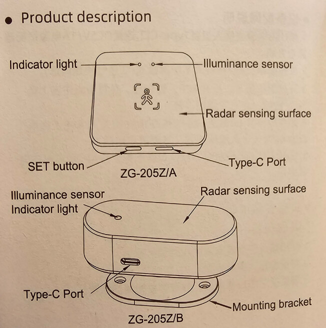

Product description
The information available on github about this radar is very little and confusing, for now, I don't know which of the existing device profiles to add it to...

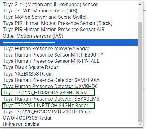

So please first update to the latest version of the 4 in 1 driver- at this time, it is 1.4.3 2023/08/17 7:34 AM.
Then from the 'Advanced Options' manually try these existing profiles :
The first profile TS0225_HL0SS9OA_RADAR is used by the device in the first post and should be now fully functional.
If it doesn't work, you can try a second profile - TS0225_LINPTECH_RADAR. It is not ready yet, but the presence/occupancy/motion detection may work with it, if the first profile fails.

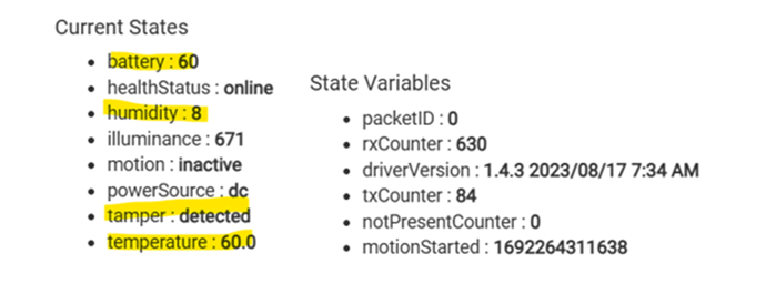

TS0225_HL0SS9OA_RADAR profile seems to be working and detecting motion, but I can't configure any settings yet as the radar specific configurations are not available.

If you hit the Refresh button, do you see a lot of debug logs generated?
Yes, hitting refresh generates a lot of debug logs, see below:

dev:26982023-08-17 11:11:13.340 AMdebugZG-205Z Radar Tuya cluster: dp_id=2 dp=110 fncmd=0
dev:26982023-08-17 11:11:13.335 AMdebugZG-205Z Radar parse (_TZE200_2aaelwxk, 1.4.3 2023/08/17 7:34 AM) descMap = [raw:catchall: 0104 EF00 01 01 0040 00 209D 01 00 0000 02 01 00B16E02000400000000, profileId:0104, clusterId:EF00, clusterInt:61184, sourceEndpoint:01, destinationEndpoint:01, options:0040, messageType:00, dni:209D, isClusterSpecific:true, isManufacturerSpecific:false, manufacturerId:0000, command:02, direction:01, data:[00, B1, 6E, 02, 00, 04, 00, 00, 00, 00]]
dev:26982023-08-17 11:11:13.330 AMdebugZG-205Z Radar parse (_TZE200_2aaelwxk, 1.4.3 2023/08/17 7:34 AM) description = catchall: 0104 EF00 01 01 0040 00 209D 01 00 0000 02 01 00B16E02000400000000
dev:26982023-08-17 11:11:13.277 AMinfoZG-205Z Radar temperature is 60.0 °C
dev:26982023-08-17 11:11:13.272 AMdebugZG-205Z Radar Tuya cluster: dp_id=2 dp=104 fncmd=600
dev:26982023-08-17 11:11:13.258 AMdebugZG-205Z Radar parse (_TZE200_2aaelwxk, 1.4.3 2023/08/17 7:34 AM) descMap = [raw:catchall: 0104 EF00 01 01 0040 00 209D 01 00 0000 02 01 00B06802000400000258, profileId:0104, clusterId:EF00, clusterInt:61184, sourceEndpoint:01, destinationEndpoint:01, options:0040, messageType:00, dni:209D, isClusterSpecific:true, isManufacturerSpecific:false, manufacturerId:0000, command:02, direction:01, data:[00, B0, 68, 02, 00, 04, 00, 00, 02, 58]]
dev:26982023-08-17 11:11:13.253 AMdebugZG-205Z Radar parse (_TZE200_2aaelwxk, 1.4.3 2023/08/17 7:34 AM) description = catchall: 0104 EF00 01 01 0040 00 209D 01 00 0000 02 01 00B06802000400000258
dev:26982023-08-17 11:11:13.132 AMwarnZG-205Z Radar non-radar event 3 fncmd = 0
dev:26982023-08-17 11:11:13.127 AMdebugZG-205Z Radar Tuya cluster: dp_id=2 dp=3 fncmd=0
dev:26982023-08-17 11:11:13.122 AMdebugZG-205Z Radar parse (_TZE200_2aaelwxk, 1.4.3 2023/08/17 7:34 AM) descMap = [raw:catchall: 0104 EF00 01 01 0040 00 209D 01 00 0000 02 01 00AF0302000400000000, profileId:0104, clusterId:EF00, clusterInt:61184, sourceEndpoint:01, destinationEndpoint:01, options:0040, messageType:00, dni:209D, isClusterSpecific:true, isManufacturerSpecific:false, manufacturerId:0000, command:02, direction:01, data:[00, AF, 03, 02, 00, 04, 00, 00, 00, 00]]
dev:26982023-08-17 11:11:13.116 AMdebugZG-205Z Radar parse (_TZE200_2aaelwxk, 1.4.3 2023/08/17 7:34 AM) description = catchall: 0104 EF00 01 01 0040 00 209D 01 00 0000 02 01 00AF0302000400000000
dev:26982023-08-17 11:11:13.061 AMwarnZG-205Z Radar ignoring getBatteryPercentageResult (1800)
dev:26982023-08-17 11:11:13.056 AMdebugZG-205Z Radar Tuya battery status report dp_id=2 dp=4 fncmd=900
dev:26982023-08-17 11:11:13.051 AMdebugZG-205Z Radar Tuya cluster: dp_id=2 dp=4 fncmd=900
dev:26982023-08-17 11:11:13.045 AMdebugZG-205Z Radar parse (_TZE200_2aaelwxk, 1.4.3 2023/08/17 7:34 AM) descMap = [raw:catchall: 0104 EF00 01 01 0040 00 209D 01 00 0000 02 01 00AE0402000400000384, profileId:0104, clusterId:EF00, clusterInt:61184, sourceEndpoint:01, destinationEndpoint:01, options:0040, messageType:00, dni:209D, isClusterSpecific:true, isManufacturerSpecific:false, manufacturerId:0000, command:02, direction:01, data:[00, AE, 04, 02, 00, 04, 00, 00, 03, 84]]
dev:26982023-08-17 11:11:13.040 AMdebugZG-205Z Radar parse (_TZE200_2aaelwxk, 1.4.3 2023/08/17 7:34 AM) description = catchall: 0104 EF00 01 01 0040 00 209D 01 00 0000 02 01 00AE0402000400000384
dev:26982023-08-17 11:11:12.850 AMdebugZG-205Z Radar ignored illuminance event 785 lux - change is less than 5 lux threshold!
dev:26982023-08-17 11:11:12.845 AMdebugZG-205Z Radar parse (_TZE200_2aaelwxk, 1.4.3 2023/08/17 7:34 AM) descMap = [raw:209D0104000A0000211571, dni:209D, endpoint:01, cluster:0400, size:0A, attrId:0000, encoding:21, command:0A, value:7115, clusterInt:1024, attrInt:0]
dev:26982023-08-17 11:11:12.839 AMdebugZG-205Z Radar parse (_TZE200_2aaelwxk, 1.4.3 2023/08/17 7:34 AM) description = read attr - raw: 209D0104000A0000211571, dni: 209D, endpoint: 01, cluster: 0400, size: 0A, attrId: 0000, encoding: 21, command: 0A, value: 1571
dev:26982023-08-17 11:11:12.739 AMinfoZG-205Z Radar Temperature Scale is: Fahrenheit (DP=0x6A fncmd = 785)
dev:26982023-08-17 11:11:12.734 AMdebugZG-205Z Radar Tuya cluster: dp_id=2 dp=106 fncmd=785
dev:26982023-08-17 11:11:12.729 AMdebugZG-205Z Radar parse (_TZE200_2aaelwxk, 1.4.3 2023/08/17 7:34 AM) descMap = [raw:catchall: 0104 EF00 01 01 0040 00 209D 01 00 0000 02 01 00AC6A02000400000311, profileId:0104, clusterId:EF00, clusterInt:61184, sourceEndpoint:01, destinationEndpoint:01, options:0040, messageType:00, dni:209D, isClusterSpecific:true, isManufacturerSpecific:false, manufacturerId:0000, command:02, direction:01, data:[00, AC, 6A, 02, 00, 04, 00, 00, 03, 11]]
dev:26982023-08-17 11:11:12.723 AMdebugZG-205Z Radar parse (_TZE200_2aaelwxk, 1.4.3 2023/08/17 7:34 AM) description = catchall: 0104 EF00 01 01 0040 00 209D 01 00 0000 02 01 00AC6A02000400000311
dev:26982023-08-17 11:11:12.541 AMinfoZG-205Z Radar battery is 60 %
dev:26982023-08-17 11:11:12.536 AMdebugZG-205Z Radar Tuya battery status report dp_id=2 dp=102 fncmd=60
dev:26982023-08-17 11:11:12.531 AMdebugZG-205Z Radar Tuya cluster: dp_id=2 dp=102 fncmd=60
dev:26982023-08-17 11:11:12.525 AMdebugZG-205Z Radar parse (_TZE200_2aaelwxk, 1.4.3 2023/08/17 7:34 AM) descMap = [raw:catchall: 0104 EF00 01 01 0040 00 209D 01 00 0000 02 01 00AB660200040000003C, profileId:0104, clusterId:EF00, clusterInt:61184, sourceEndpoint:01, destinationEndpoint:01, options:0040, messageType:00, dni:209D, isClusterSpecific:true, isManufacturerSpecific:false, manufacturerId:0000, command:02, direction:01, data:[00, AB, 66, 02, 00, 04, 00, 00, 00, 3C]]
dev:26982023-08-17 11:11:12.520 AMdebugZG-205Z Radar parse (_TZE200_2aaelwxk, 1.4.3 2023/08/17 7:34 AM) description = catchall: 0104 EF00 01 01 0040 00 209D 01 00 0000 02 01 00AB660200040000003C
dev:26982023-08-17 11:11:12.454 AMinfoZG-205Z Radar Motion is active 0s
dev:26982023-08-17 11:11:12.449 AMdebugZG-205Z Radar parse: zone status: zone status 0x0001 -- extended status 0x00 - sourceEndpoint:01, zoneId:FF, delay:0000
dev:26982023-08-17 11:11:12.441 AMdebugZG-205Z Radar parse (_TZE200_2aaelwxk, 1.4.3 2023/08/17 7:34 AM) description = zone status 0x0001 -- extended status 0x00 - sourceEndpoint:01, zoneId:FF, delay:0000
dev:26982023-08-17 11:11:12.351 AMwarnZG-205Z Radar non-radar static dwell alarm 0x75 fncmd = 1
dev:26982023-08-17 11:11:12.344 AMdebugZG-205Z Radar Tuya cluster: dp_id=4 dp=117 fncmd=1
dev:26982023-08-17 11:11:12.330 AMdebugZG-205Z Radar parse (_TZE200_2aaelwxk, 1.4.3 2023/08/17 7:34 AM) descMap = [raw:catchall: 0104 EF00 01 01 0040 00 209D 01 00 0000 02 01 00A97504000101, profileId:0104, clusterId:EF00, clusterInt:61184, sourceEndpoint:01, destinationEndpoint:01, options:0040, messageType:00, dni:209D, isClusterSpecific:true, isManufacturerSpecific:false, manufacturerId:0000, command:02, direction:01, data:[00, A9, 75, 04, 00, 01, 01]]
dev:26982023-08-17 11:11:12.321 AMdebugZG-205Z Radar parse (_TZE200_2aaelwxk, 1.4.3 2023/08/17 7:34 AM) description = catchall: 0104 EF00 01 01 0040 00 209D 01 00 0000 02 01 00A97504000101
dev:26982023-08-17 11:11:12.225 AMinfoZG-205Z Radar Motion is active 0s
dev:26982023-08-17 11:11:12.216 AMdebugZG-205Z Radar motion event 0x65 fncmd = 2
dev:26982023-08-17 11:11:12.209 AMdebugZG-205Z Radar Tuya cluster: dp_id=4 dp=101 fncmd=2
dev:26982023-08-17 11:11:12.197 AMdebugZG-205Z Radar parse (_TZE200_2aaelwxk, 1.4.3 2023/08/17 7:34 AM) descMap = [raw:catchall: 0104 EF00 01 01 0040 00 209D 01 00 0000 02 01 00A86504000102, profileId:0104, clusterId:EF00, clusterInt:61184, sourceEndpoint:01, destinationEndpoint:01, options:0040, messageType:00, dni:209D, isClusterSpecific:true, isManufacturerSpecific:false, manufacturerId:0000, command:02, direction:01, data:[00, A8, 65, 04, 00, 01, 02]]
dev:26982023-08-17 11:11:12.191 AMdebugZG-205Z Radar parse (_TZE200_2aaelwxk, 1.4.3 2023/08/17 7:34 AM) description = catchall: 0104 EF00 01 01 0040 00 209D 01 00 0000 02 01 00A86504000102
dev:26982023-08-17 11:11:12.138 AMinfoZG-205Z Radar Detected motion
dev:26982023-08-17 11:11:12.133 AMdebugZG-205Z Radar (DP=0x01) motion event fncmd = 1
dev:26982023-08-17 11:11:12.128 AMdebugZG-205Z Radar Tuya cluster: dp_id=4 dp=1 fncmd=1
dev:26982023-08-17 11:11:12.120 AMdebugZG-205Z Radar parse (_TZE200_2aaelwxk, 1.4.3 2023/08/17 7:34 AM) descMap = [raw:catchall: 0104 EF00 01 01 0040 00 209D 01 00 0000 02 01 00A70104000101, profileId:0104, clusterId:EF00, clusterInt:61184, sourceEndpoint:01, destinationEndpoint:01, options:0040, messageType:00, dni:209D, isClusterSpecific:true, isManufacturerSpecific:false, manufacturerId:0000, command:02, direction:01, data:[00, A7, 01, 04, 00, 01, 01]]
dev:26982023-08-17 11:11:12.114 AMdebugZG-205Z Radar parse (_TZE200_2aaelwxk, 1.4.3 2023/08/17 7:34 AM) description = catchall: 0104 EF00 01 01 0040 00 209D 01 00 0000 02 01 00A70104000101
dev:26982023-08-17 11:11:11.840 AMdebugZG-205Z Radar device has received Tuya cluster ZCL command 0x03 response 0x00 data = [03, 00]
dev:26982023-08-17 11:11:11.821 AMdebugZG-205Z Radar parse (_TZE200_2aaelwxk, 1.4.3 2023/08/17 7:34 AM) descMap = [raw:catchall: 0104 EF00 01 01 0040 00 209D 00 00 0000 0B 01 0300, profileId:0104, clusterId:EF00, clusterInt:61184, sourceEndpoint:01, destinationEndpoint:01, options:0040, messageType:00, dni:209D, isClusterSpecific:false, isManufacturerSpecific:false, manufacturerId:0000, command:0B, direction:01, data:[03, 00]]
dev:26982023-08-17 11:11:11.815 AMdebugZG-205Z Radar parse (_TZE200_2aaelwxk, 1.4.3 2023/08/17 7:34 AM) description = catchall: 0104 EF00 01 01 0040 00 209D 00 00 0000 0B 01 0300
dev:26982023-08-17 11:11:11.498 AMdebugZG-205Z Radar NOT PARSED : descMap = [raw:catchall: 0104 0001 01 01 0040 00 209D 00 00 0000 01 01 210086, profileId:0104, clusterId:0001, clusterInt:1, sourceEndpoint:01, destinationEndpoint:01, options:0040, messageType:00, dni:209D, isClusterSpecific:false, isManufacturerSpecific:false, manufacturerId:0000, command:01, direction:01, data:[21, 00, 86]]
dev:26982023-08-17 11:11:11.490 AMdebugZG-205Z Radar parse (_TZE200_2aaelwxk, 1.4.3 2023/08/17 7:34 AM) descMap = [raw:catchall: 0104 0001 01 01 0040 00 209D 00 00 0000 01 01 210086, profileId:0104, clusterId:0001, clusterInt:1, sourceEndpoint:01, destinationEndpoint:01, options:0040, messageType:00, dni:209D, isClusterSpecific:false, isManufacturerSpecific:false, manufacturerId:0000, command:01, direction:01, data:[21, 00, 86]]
dev:26982023-08-17 11:11:11.467 AMdebugZG-205Z Radar parse (_TZE200_2aaelwxk, 1.4.3 2023/08/17 7:34 AM) description = catchall: 0104 0001 01 01 0040 00 209D 00 00 0000 01 01 210086
dev:26982023-08-17 11:11:11.370 AMdebugZG-205Z Radar NOT PARSED : descMap = [raw:catchall: 0104 0001 01 01 0040 00 209D 00 00 0000 01 01 200086, profileId:0104, clusterId:0001, clusterInt:1, sourceEndpoint:01, destinationEndpoint:01, options:0040, messageType:00, dni:209D, isClusterSpecific:false, isManufacturerSpecific:false, manufacturerId:0000, command:01, direction:01, data:[20, 00, 86]]
dev:26982023-08-17 11:11:11.359 AMdebugZG-205Z Radar parse (_TZE200_2aaelwxk, 1.4.3 2023/08/17 7:34 AM) descMap = [raw:catchall: 0104 0001 01 01 0040 00 209D 00 00 0000 01 01 200086, profileId:0104, clusterId:0001, clusterInt:1, sourceEndpoint:01, destinationEndpoint:01, options:0040, messageType:00, dni:209D, isClusterSpecific:false, isManufacturerSpecific:false, manufacturerId:0000, command:01, direction:01, data:[20, 00, 86]]
dev:26982023-08-17 11:11:11.344 AMdebugZG-205Z Radar parse (_TZE200_2aaelwxk, 1.4.3 2023/08/17 7:34 AM) description = catchall: 0104 0001 01 01 0040 00 209D 00 00 0000 01 01 200086
Thanks!
The good news is that the radar fits in the new not-so-spammy series and has the same multiple configuration settings as the TS0225_HL0SS9OA device. Also, the Z2M decoding matches your debug logs.
The bad news is that the 'data points' are again different, and this device will need one more 'device profile' to be added to the 4-in-1 driver.
BTW, the basic functionality of this radar (motion and illuminance) should work with HE inbuilt Zigbee drivers!
You can experiment with some inbuilt Generic Zigbee drivers that support motion and illuminance.
Matter compatibility is coming earlier for Tuya devices! :sweat_smile:
Hi @kkossev ,
Just received my sensors today.
Created copy for the Tuya 4 in 1 driver (the regular version in being used for my older spammy sensor).
Did a zigbee pair and the device was found and was assigned the correct driver automatically.
Any special tests you would like me to run?
What are the Device Profiles’ automatically assigned to your new devices? (State Variables section)
For new devices it is always advised to install the latest development branch version driver, the main version may be many months old.. (as the case with Aqara P1 driver for example).
