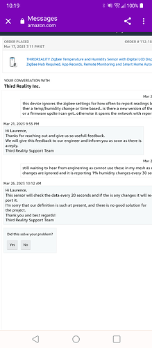

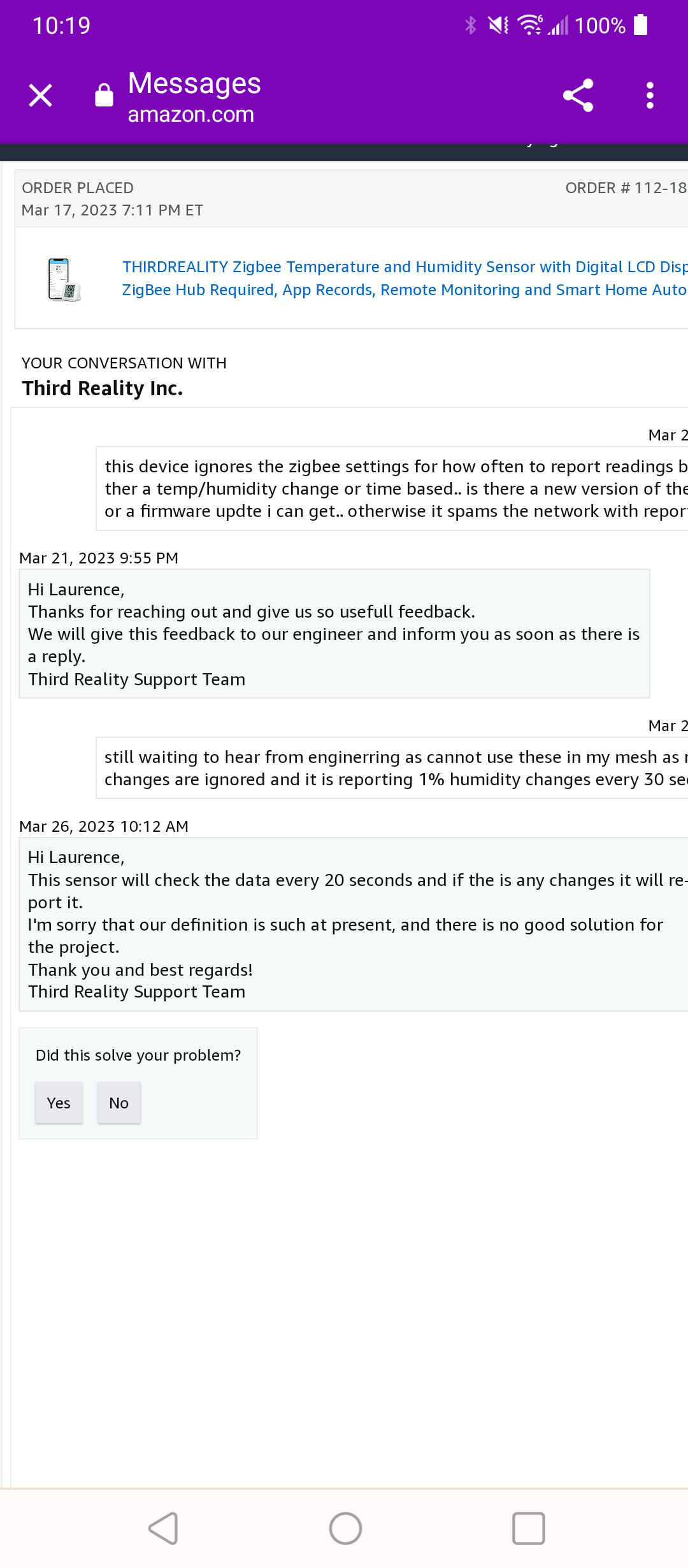

Doesn't work well in wine fridge. Ignores config parameters and sends humidity updates on every 1% change which can be every 30 secs in wine fridge. Removed from my mesh for this reason.

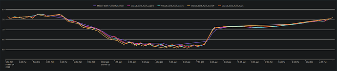

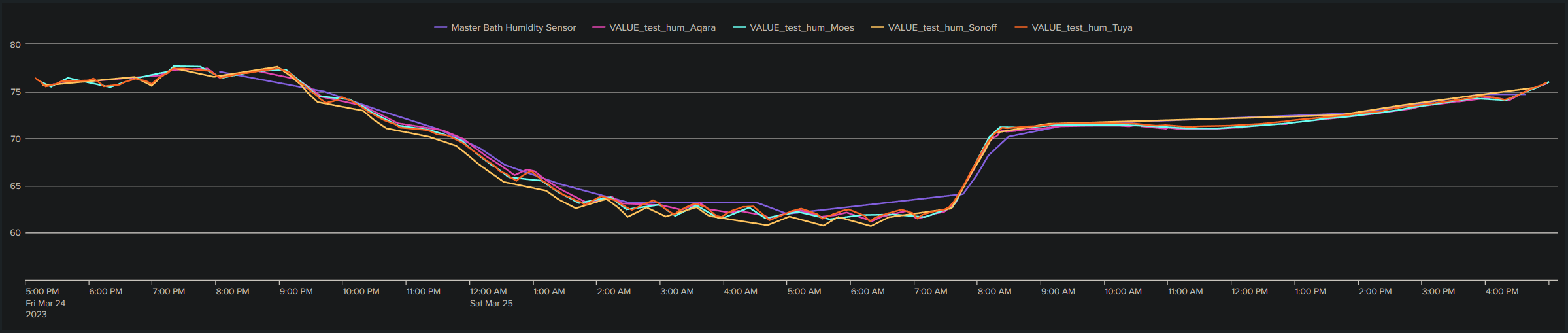

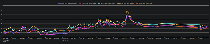

And the consensus is...they're all in the category of "alright." This is just subjective testing to see how they compare to each other:
So, they all read within a few % of each other. Temp seems to be much closer.
These are:
Master Bath Zooz ZSE44
Aqara WSDCGQ11LM
Moes ST-TH01
Tuya - ?
Sonoff SNZB-02

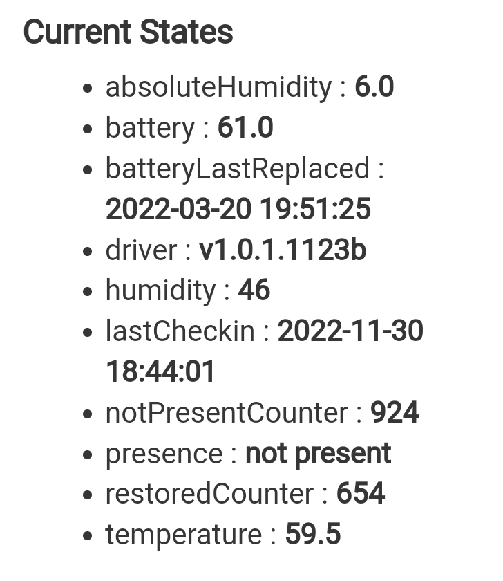

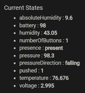

This is also important to remember. Some sensors also report "absolute humidity" which is independent of temperature. You can also use an app to calculate dewpoint, which also helps compare areas with different temperatures.

They confirmed the behavior and are not fixing. Unfortunately into my junk box.

Ya just not good in a location that has frequent temp snd humidity changes like a wine fridge.
I see quite a few 20-30 sec. humidity changes in your logs as well.. that is not good for the mesh. And unnecessary.
