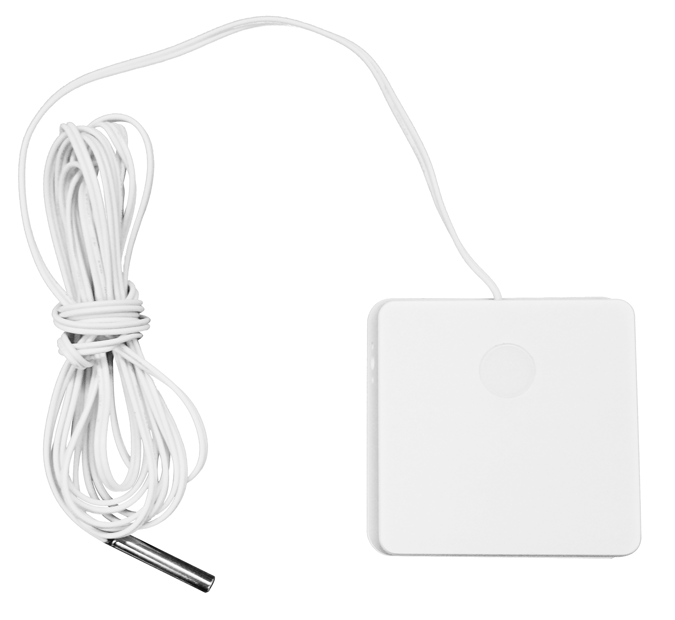

Here's one that popped up...sourcing may be a challenge but I haven't exhausted the search yet.
So this might be of Tuya lineage. Might get @kkossev 's opinion given his knowledge there.
Edit: This is the makings of a whole 'nuther thread but it sure seems like there's a heck of a big head of Tuya/Zigbee steam pumping out an awful lot of devices and variants. (No comment on quality, innovation, or IP ownership)

Although it is not a Tuya device, the OWON THS317-ET is supported in the Tuya driver.
