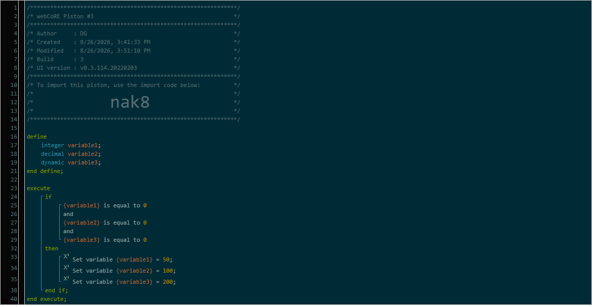

System variables are gone in one of my webcore pistons
HI,
I just open one of my piston to make somes little changes and notice that some expression where I use $variable were in red and unresolved, so I notice that the system variables are not even listed like it no longer exist.
In my other pistons its still ok, so I need your help on that one! Why only this piston wont connect to the system variables?
Thanks!
I suggest check this steps
Up to date and still no system variable in this particular piston.
Looks like a bad link from the piston itself… those variable used inside are working great but are in red in the expression like the link is lost with the system variable…
I also tried to create a duplicate piston which works before to save it. Before to save I was able to access system variable but as soon as I save, I first get an error message (sorry but an error occur while saving) or something like that and then the piston is there but no access to system variable anymore.
Piston s logs are normals... Still don't know why the system variables are gone...
Is this issue have a chance to be solved ? I just made another piston and it looks like that over around 50 compilation steps (the number shown when saving piston) those variable are gone... The bug looks to come from the app itself. I use the built in webcore app... Am I the only with this issue?
