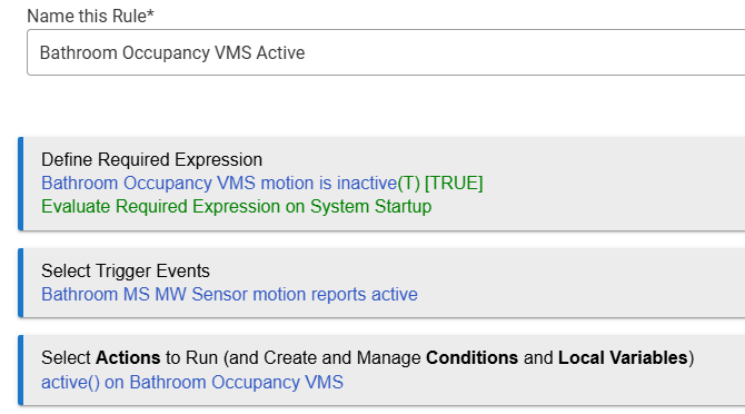

This example rule is triggered when Occupancy VMS (this is virtual device) becomes active, waits for all 3 MS becomes inactive for the certain time and once condition is met deactivates Occupancy VMS. Occupancy VMS is a part of many other bathroom automations rules.
Just in case here is a rule for activating Occupancy VMS:
These two rules is a simple Ocuupancy State Machine with only two active states.
I will be very surprised if you tell me these rules are problematic.
Waits are fine. Rules don't actually wait; wait actions behave similar to triggers. All that happens is an event subscription is created and the rule execution stops, only to be woken up when the subscribed event occurs: the condition for the wait is evaluated, and if true, the rule continues with the next action(s). Waits get cancelled on rule retriggering, so no stacking / multiple simultaneous instances of one rule (delays are another story). Most if not all of this is covered in the documentation
