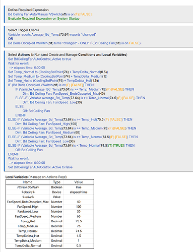

Yes. But I am using a DIMMER (not a preset speeds) for setting speed to whatever percentage I want. Sorry, I didn't know how to grab a screen on Android to show my rule.

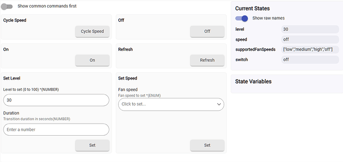

No. Fan Controller is used to control Fan speeds and Lamp Dimmer is used for dimming bulbs. Fan Driver has a Set Level option:

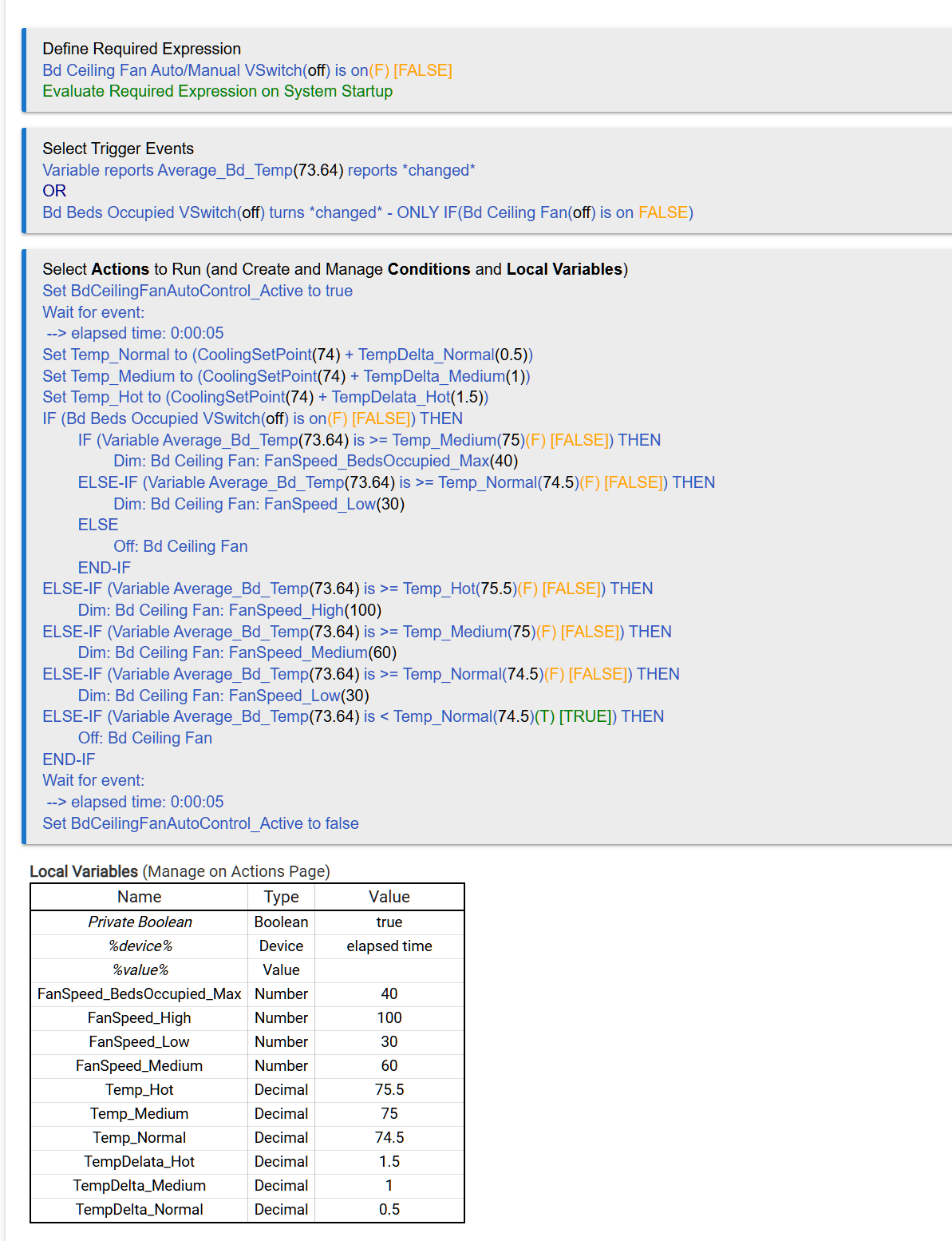

and I am using it to control Fan Speeds. Here is a rule:

You only show 3 discrete fan speeds though.... Hi/Med/Low.
This is what I was asking about.... MORE than ONLY 3 speeds.
Again, I am using Set Level option in a fan child driver (not a preset speeds). As you can see, my rule defines 4 speeds to whatever level in percentaige I want (0-100%). I did not test all 100 potential levels but tested in increment of 10%. My fans responded very well. For the rule I picked final speeds after few itterations.
