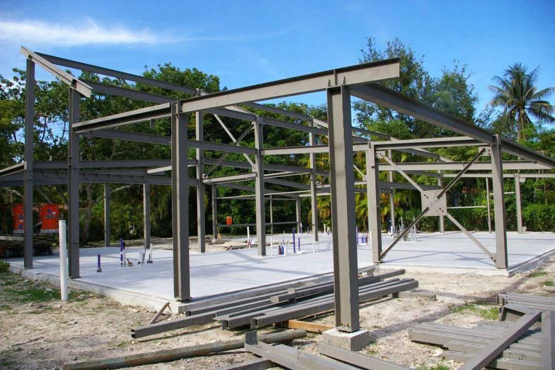

My house is surrounded with metal beams (something like this); I wonder whether this has caused the zwave frequency to work slower in my house.
