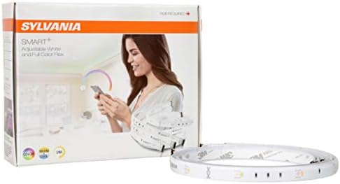

This light:
This driver: Generic ZigBee RGBW Light
