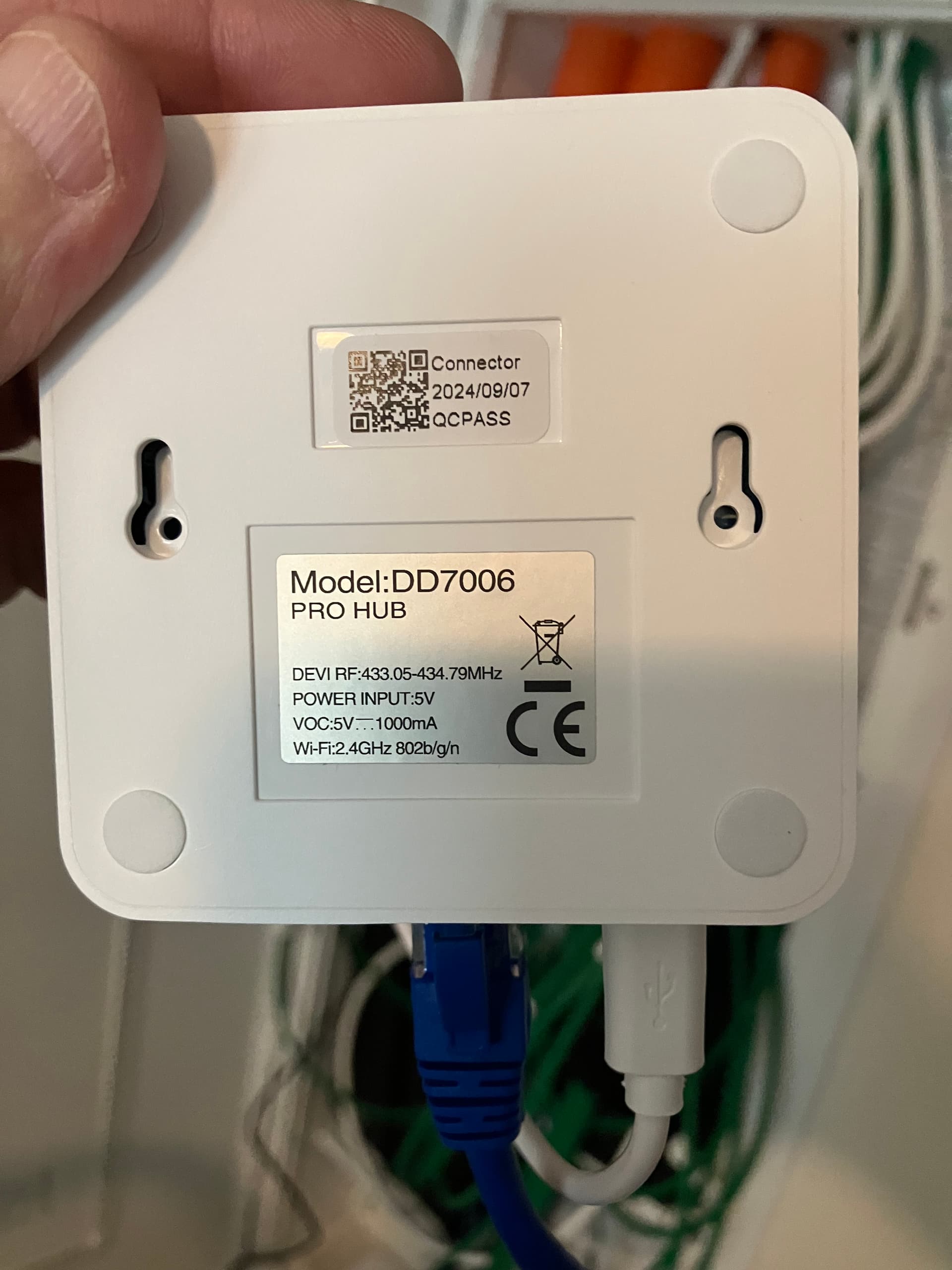

My wife had a window blind controller installed. Based on the pic of the controller, it appears to be a Smart Window device: Controller website
It is WiFi connected but wondering if anyone has interfaced to this hub?

From what I can gather from that site, these use their own RF frequencies, and this hub you want to connect bridges those RF signals to Wifi, like a wifi controlled remote. So the hub just bridges wifi commands over to RF commands, the same ones used with the remotes shown on the site,
That makes me wonder if you need this bridge at all. It seems to be doing something very similar to what a Bond or Broadlink RF bridge will do. If those RF signals that the remote (and the bridge) use can be captured by a standard RF bridge device, you would not even need that bridge.
There are local drivers available for both Bond and Broadlink RF bridge devices from the community, that just use local wifi back to the hub. I guess you already bought this bridge hub for $250, but a Bond or Broadlink bridge is much cheaper and may be able to do the same thing with Hubitat driver support already there.
That assumes Smart Window does not use rolling codes or security in their RF signals, and that those RF commands can be captured by a Bond or Broadlink Device.

Ok. From the website, it really looks like the remotes use RF and IR:
" We supply several different kinds of remote controls to meet your different requirements.
We also supply 'Broadlink home automation universal IR+RF control' to let you control your motorised curtains and roller blinds remotely
You are correct. I was able to use the remote with the gateway powered off.

Note this on their FAQ:
Q. Can I use my smartphone or tablet to control my motorised curtains or roller blinds remotely in the home or away from the home?
A. Yes, you can use either Broadlink RM Pro IR+RF Universal Hub or our new product - WIFI Bridge. Broadlink RM Pro is good, but WIFI bridge is much better. It's easy to connect and has more functions, it can control all of our RF motorised curtain and roller blind devices
So, they built a specific Broadlink type wifi bridge device that probably does RF codes for some of their other blinds that Broadlink cannot do. If you do not have those RF blinds, the bridge that you bought is just a specific use-case Broadlink-type device, with the codes built in.
Makes me wonder what happens if you connect the bridge you bought, using the Broadlink driver with the IP of your bridge.
