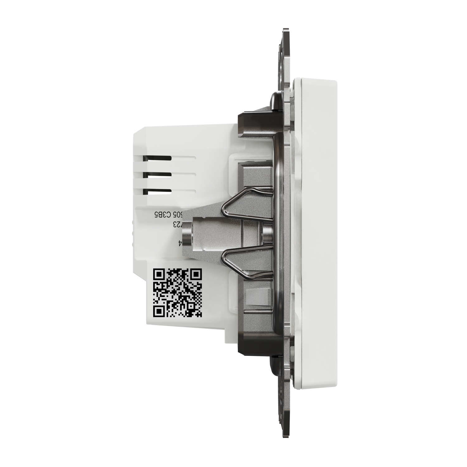

PS. I am still having difficulties connecting the button. I can easily get it to flash green with 3 clicks but it will not reset with 4 clicks. Id does not connect with 3 clicks so I assume it is because it was connected once before and it needs a reset. I have asked the electricican to bring another example of the button just to verif that it is nothing physically wrong with the button I have, It might be a few days before he comes around witht he new button and I can test it.
I think that I found and fixed the HPM 'Invalid Package File' issue (it was a typo in the repository file).
This weekend I migrated my old C-7-DEV hub to a new C-8-PRO, and I also had a hard time pairing the Schneider Wiser button. It is obligatory that the device is factory reset when moving between hubs.
The reset procedure that worked for me is - 4 clicks, the first 3 are short and the fourth one is long - you must keep the upper right button pressed until you first see a short green flash around the 5th second and then all the LEDS should start flashing red after the 10th seconds.
Then, the three-clicks procedure puts the device into pairing mode with the new hub,
Thanks for sharing Krassimir. In my case I think there is something wrong with the button (I have the single version with only one button). The electrician came by with a new button today and it lit up as a christmas tree This button has bright lights whereas the first one I used, besides never showing any red light, I had to sitt in a complete dark room to see the faint glow. The new one connected instantly and found the correct (your eminent) driver. I did a quick test now just before dinner and it worked well with a simple toggle on off rule. Brilliant Krassimir! Many thanks!
