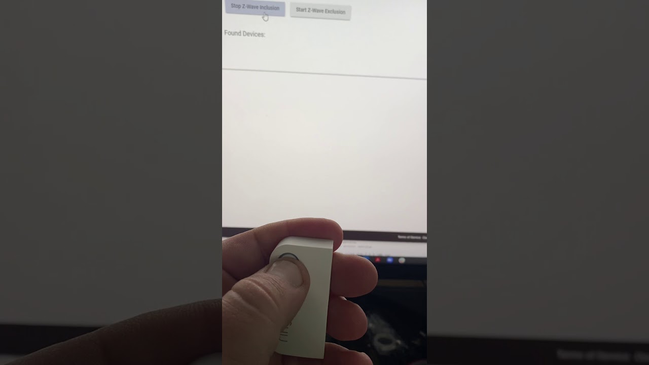

I am and they do not work. I just opened a 2nd Ring Gen 2 contact sensor and paired it S2 C1 and it created the device like it should, but it is not seeing that open/closes happening.
Hang on.. Going to include a new one..
This is what I am seeing in the logs when i pair the new unit:

In case you are curious .. the one I just included shows to be firmware version 1.15
