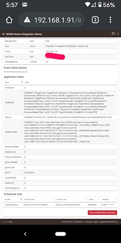

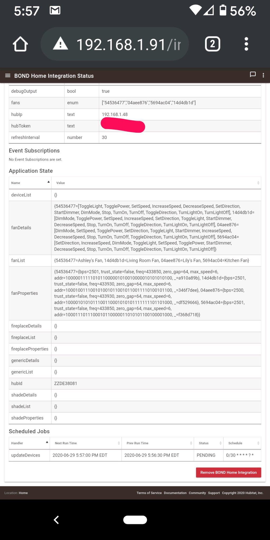

Cool. Last thing could you click the gear icon next to the app and provide the properties (like fan properties?). You can mask out your token for security. I’ll try to look into this later tonight. Please also make sure you have the latest code, I changed a bunch this weekend
Here you go. Hopefully you can see it. I updated everything using Package Manager this morning. I appreciate your time. Thanks

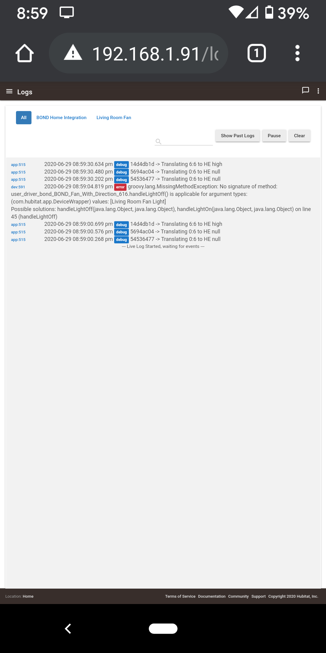

Do you get anything in the logs when you actually try to control the light? The logs you pasted are unfortunately related to fan speed, nothing there about the lights

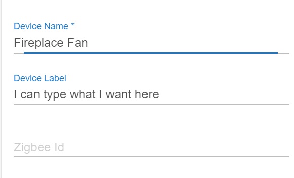

Also changing the label is working for me:
Not being able to change the name is just the way HE works, nothing I can do about that.

Not sure if that was meant for me but here's the screenshot. If it was meant for me GitHub is still showing the sane version I have and still doesn't work. Thanks again.
It wasn't but now that I've seen your error it should fix it too. I think it was a github cache issue, a new version (1.3.2) should be available now. Github delays things by up top 5-10 mins.
Great confirmed the off now works. Thanks again mate!

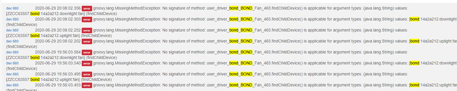

I am getting similar on all 4 fans. Sometimes, it will turn on fan but won't turn it right back off or change speeds. Trying to control the liight never works. I updated to 1.3.2 thru HPM and have tried unplugging and re-plugging in Bond Home. I can control fine thru Bond app.
This just started happening in last 24-48 hours.
Are you doing anything when this happens? What driver is device 680?
1.3.3 should fix all these errors now (sorry I have no fans to test with so I'm relying on others!) but would still be helpful to have some details @stephen_nutt
I was getting the same errors (I didn't look initially) I then just applied 1.3.3 and confirmed it's resolved.
All good for me too. Thanks
