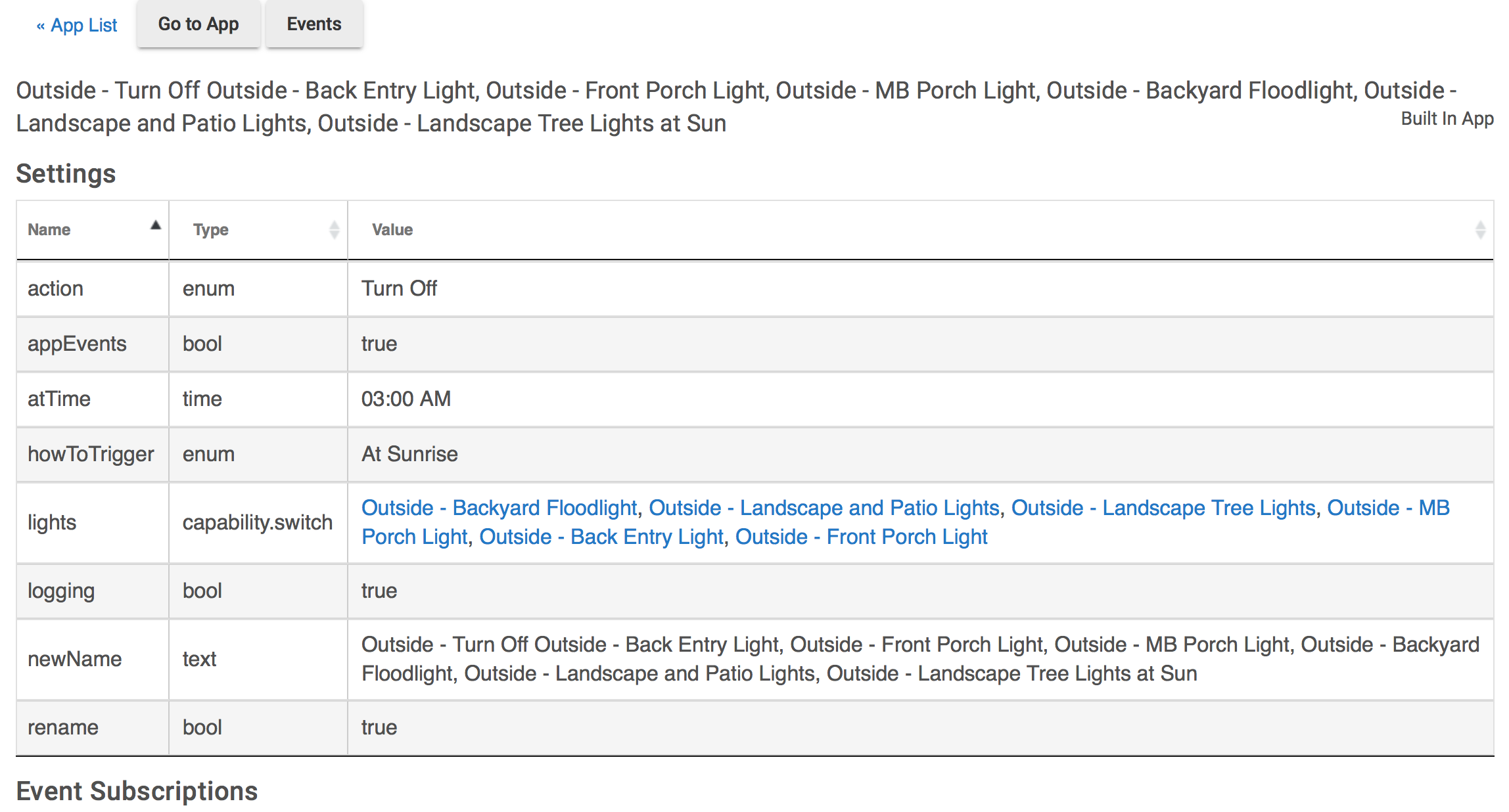

So after updating to 2.2.3.145, it appears a bug has shown up in the "Simple Automation Rules". My automations that use a sunrise / sunset trigger seem to be failing to run. If I go into them and manually run them, they work, but they just appear to be missing the trigger. When I look at the logs, I don't see the rule trying to run or the devices in question being triggered. I do however see the devices being triggered correctly from the Rule Machine.
Can you post a screenshot of the App Status page for this rule, the portion where it shows Event Subscriptions. Also, please post a screenshot of your System Events log, from the main left side menu.
You can see that the system is sending the sunrise event. The App Status page is the gear icon in the app (upper right) on the gear left of the app name in the Apps list.
OK, I'm missing something. It sure appears to be turning them off at sunset. Pull up one of the Events for one of the switched (from top of device page). Show that.
The rule is running as it should, so if the lights aren't turning off we need to dig a bit deeper into that.
You can see from those logs that it stopped working around 7/20? But I only really noticed that it stopped after the last update.
Here are the other screen shots of what I think you are looking for from one of the switched devices. You will see that the strange 2036 Date in the first parts of the logs followed by the entries. I see the dimming events from rule machine, but not the events from the Simple Lighting Automation.
My suggestion is to remove that rule, and recreate it again. That should get it working again. I don't know about that 2036 thing, but it seems like something went off the rails.

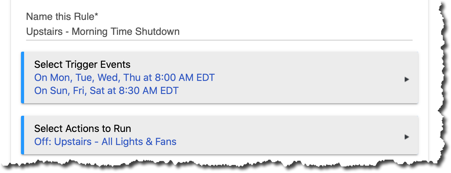

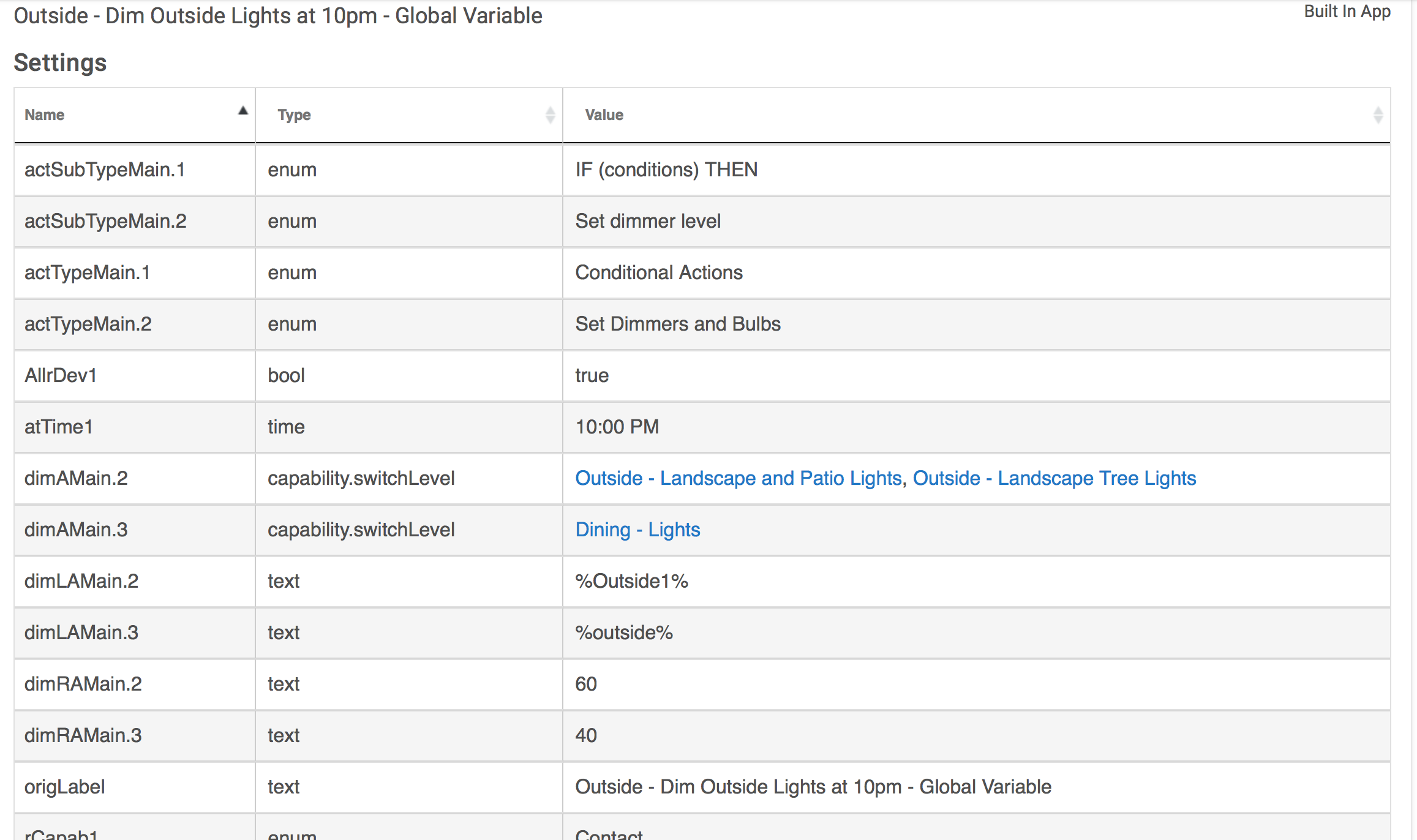

Some of my rules have also not been working, and I got around digging more this weekend. I have the same exact issue.... looks like that a bunch of my rules stopped working on July 20th as well (07/20). I was going to post my case but then saw this thread, thus adding a few of my examples here itself. Suggestions for me @bravenel ? :
Well, looking further it into it. Looks like the event logging stopped on 07/20 for ALL rules, but some of the rules are working as intended. For example this rule most definitely fires every day:
