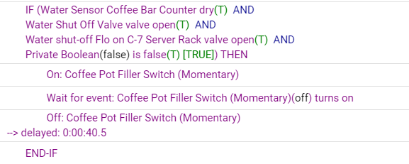

Unfortunately, the device can't accept a "pulse duration" command. Here's what I have set up for my coffee pot filler valve:
I put the "wait for on" in there to try to get the timer to be as accurate as possible in case there was a delay in the switch turning on. The trigger in my case is a button, not a contact, but would work the same. Also, mine is on a ZEN 16, but again, shouldn't matter.

I completely forgot about that and it could definitely work for @user5032. It couldn't work for me because I have buttons for 1/3, 2/3, and full pots of coffee.
I do have that parameter configured for 41 seconds though as yet another "overfill safety" since my coffee pot takes 40.5 seconds to fill.
I'd have water all over the place if I tried that automation!

Believe me, it still makes me a tad nervous. I have as much safety built into it as I can think of including a leak sensor that sits right beside the coffee pot on the counter that has a rule that completely shuts everything down. The private Boolean you see in my 'if' is to make it so the buttons lock out after being used once in a day etc.
That said, I'm positive that someday I'm going to wake up to a mess, but for now, I really like the system!
