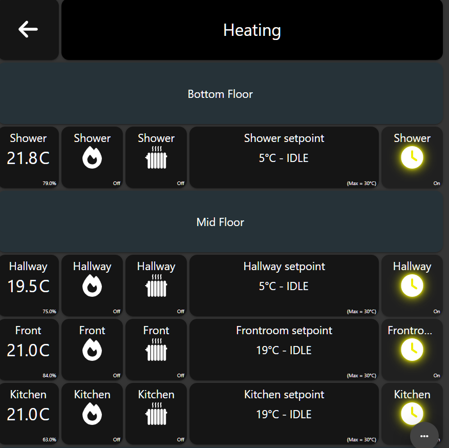

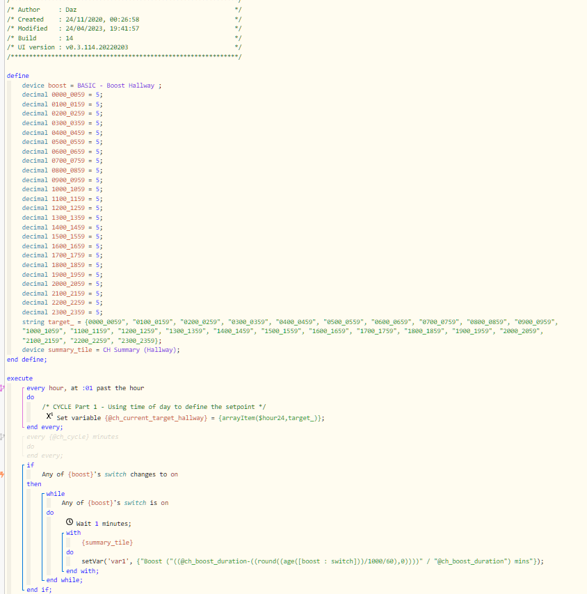

@swegner
I use loads of them.
nodemcu/konnected/dht22
