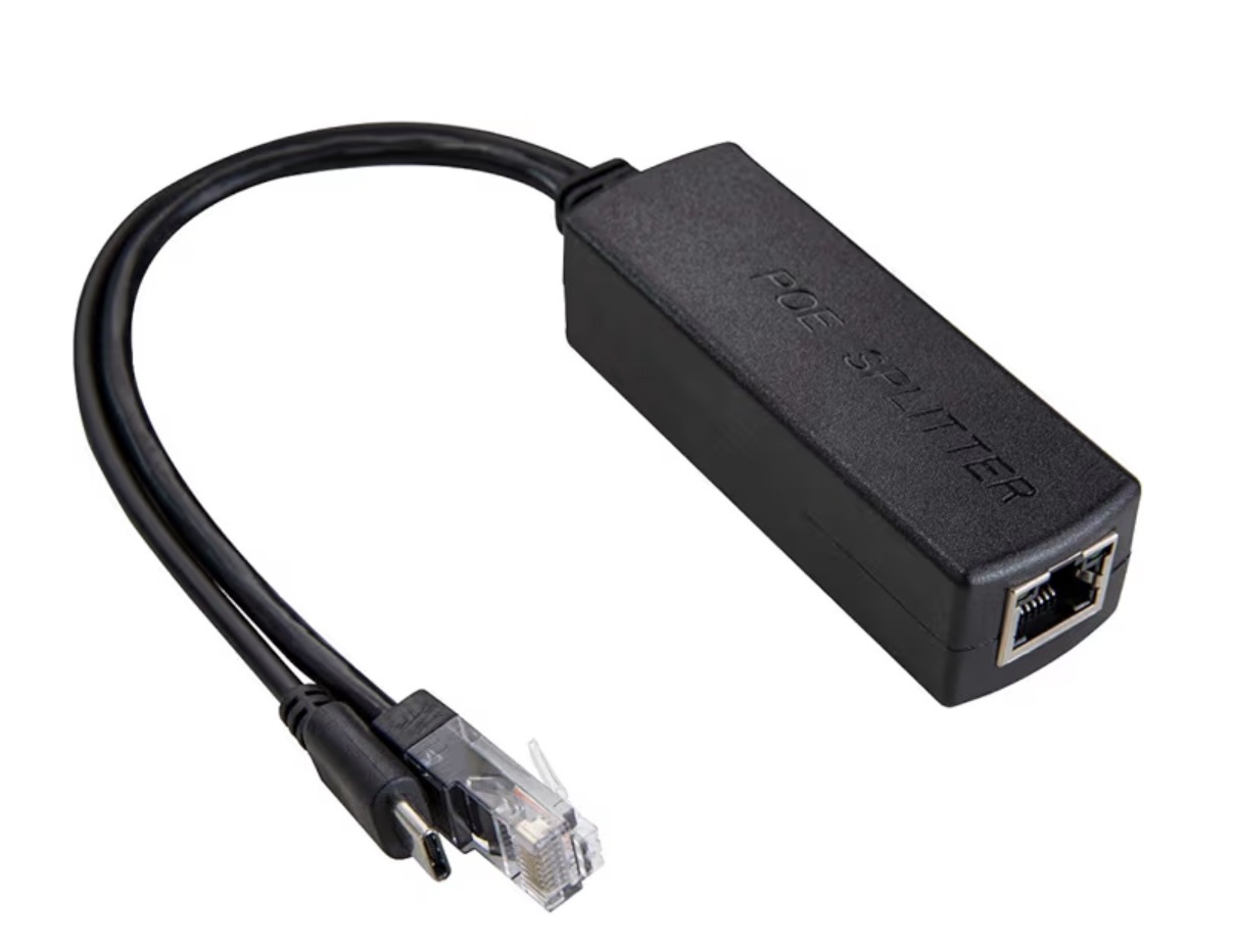

Just a heads up on a success story. I purchased this PoE splitter from Amazon and successfully using it with my Ubiquiti PoE switch.
Why? Ability to use a single ethernet cable to provide both network and power to your hub, no need for a power outlet. Additionally, you can focus on reliable and backup power for your PoE switch which then in virtue protects your hub.

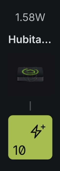

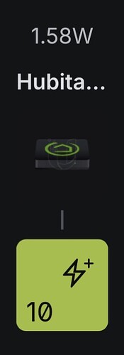

The UniFi switch is reporting the PoE splitter is running in “PoE+” mode but the PoE draw (and tax on the switch’s power budget) is less than 2W. Very efficient and cheap way to simply the power and cabling situation for your Hubitat.
Congrats...but you may end up w/issues over time, the C8 line is picky about its power and using some POE devices was identified as a source of significant Z-Wave isssues that would appear over time, folks often found their POE success to be short-lived.
You should read this if you're going to do POE w/a C8-Pro:
Been there, tested that. :melting_face:
I do the same, but I first verified the output with my DL24 load tester to be certain my POE adapter can put out 12.5 watts without a hitch. Then to be certain, my POE only powers a PiPower UPS with 2x 21700 lithium cells which smooths out the power to the hub. The PiPower can output a rock steady 5 volts at 3 amps. So it's doing double duty UPS & power supply.
I tried that same UCTronics PoE splitter, and know that it does not work reliably with the C8/C8Pro Z-Wave radio.
Use one of the ones from @dennypage‘s thread where various splitters were tested very scientifically.
