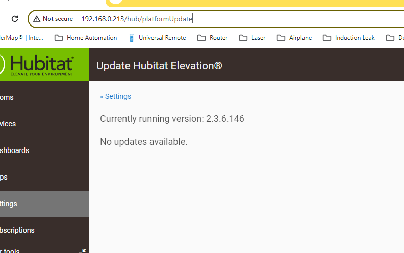

Thanks for feedback. Looks like your C-7 is connected to the cloud but running 2.2.6. Can you please update to the latest release (2.3.6) then run another backup?

I see this on the C7:
Yes, I have rebooted (power cycled) the C7 several times since the update.
