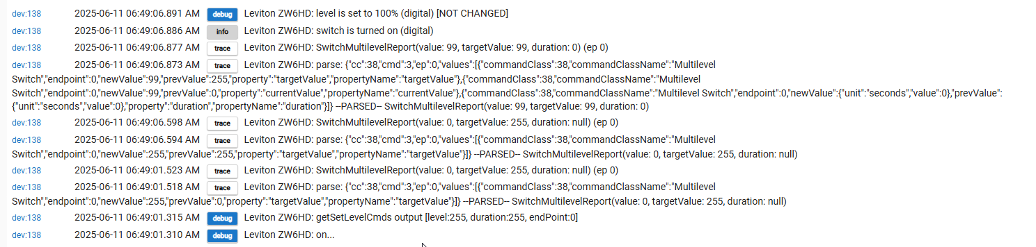

I found this same thing for MultilevelSwitchCCSet which I posted over in beta for anyone who has access you can see the whole thread.
Just trying this two reports together.
After activating the device physically where the duration works a few times, leaving it OFF. Then if I activate to ON from the hub, this first time it sorts of works better from the perspective of the driver, since I get a duration. However this is horribly inefficient for Z-wave traffic.
It still looks like the hub is sending TWO on commands in a row for some reason. In this case both came back with Success duration of 0 (not sure why no duration 3 this time, device quirk maybe). But then after that it looks like the hub took it upon itself to send a MultilevelSwitch Get? That is what finally resulted in the duration getting passed back to the driver.
Is something broken with the supervision response handling?
2025-06-11 06:49:06.587 AMDRIVER « [Node 043] [REQ] [BridgeApplicationCommand] - │ RSSI: -74 dBm - └─[Security2CCMessageEncapsulation] - │ sequence number: 41 - │ security class: S2_Authenticated - └─[MultilevelSwitchCCReport] - current value: 99 - target value: 99 - duration: 0s
