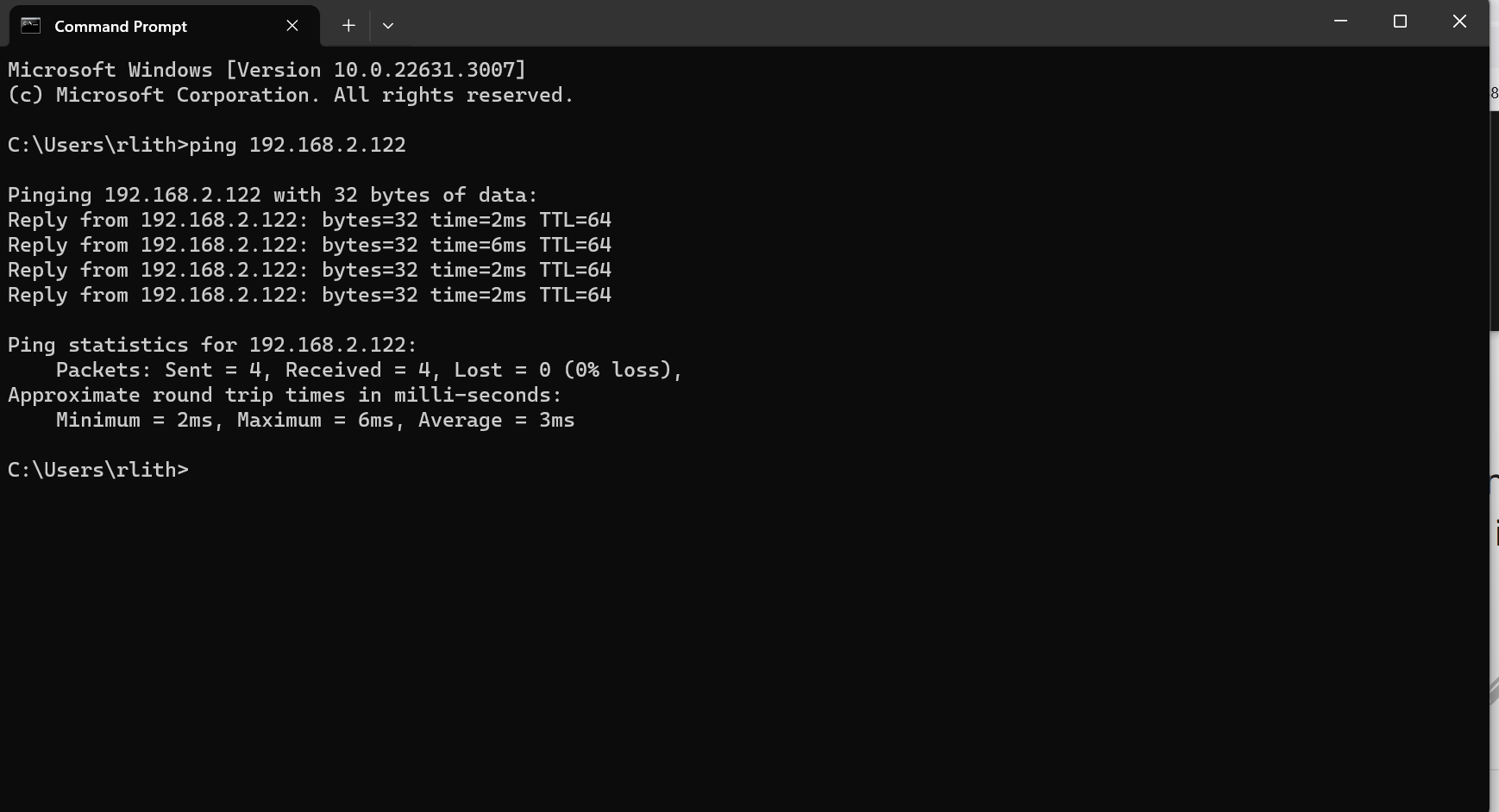

can you ping that ip from your laptop?
I don't know how to do that. Also the mac and I p binding is on
click start, type CMD and click the command prompt icon when it comes up. At the command line, type ping xxx.xxx.xxx.xxx (where x is the ip address of the hub)

type the word ping before the ip. Also you can use windows snip to copy and paste screen shots
Type o on the address let me try it again
put a space between ping and the ip (see my screen shot above)

I was able to ping it
