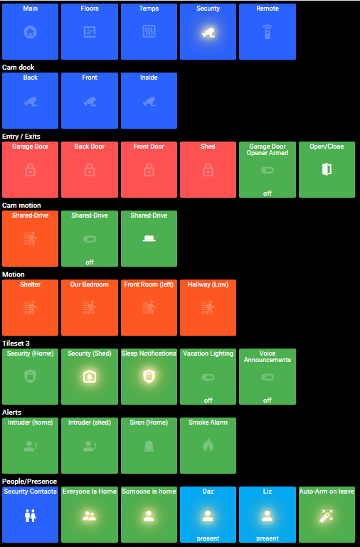

In answer to the question, I prefer multiple pages, simplified. I hate the look of those dash's which have too much info. (edit - mine's a work in progress, I still want to strip out quite a bit)
