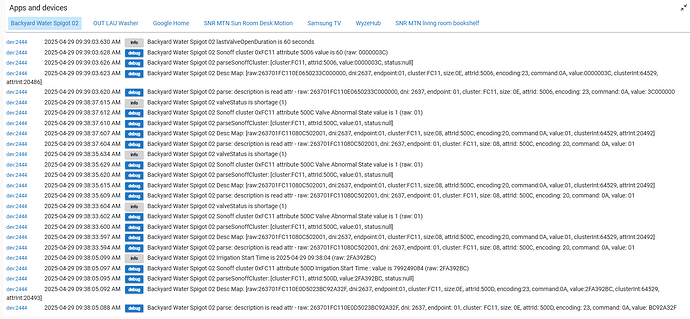

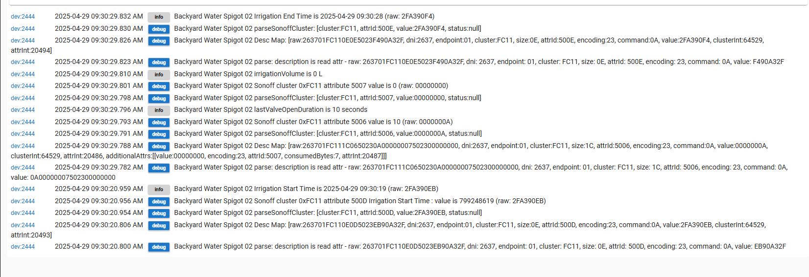

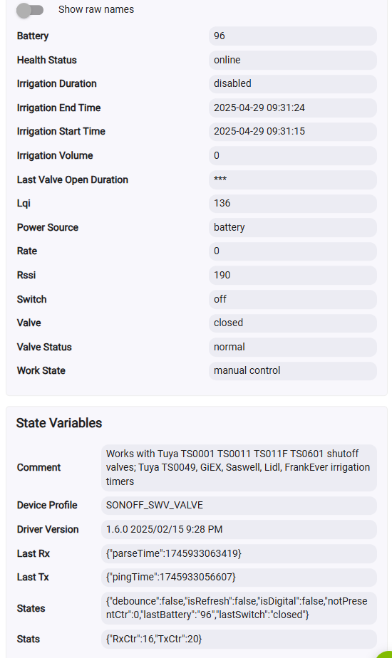

+1 on this. I have the same issue I believe. Just got 2 of these, both fail to report Open / Close when operating from the physical button.
They do update the irrigation start / end time (start for open valve, end for close valve). Additionally, if I send a refresh command to them, they update both the switch and valve states appropriately.
One of the devices I joined without the Tuya driver being added. I added the driver, manually swapped it over, then performed an initialize, configure, refresh (that order). Device was controllable, but on/off manual did not update.
I deleted the device (drop from zigbee, removed from hubitat), and rejoined, performed same ICR, same state. I then joined second device. If found driver right away. Performed ICR, same state.

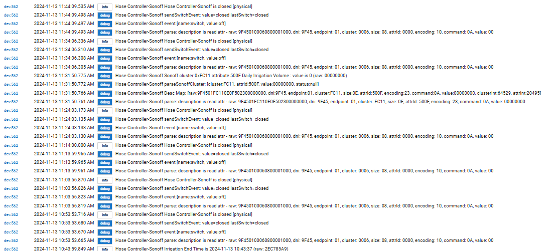

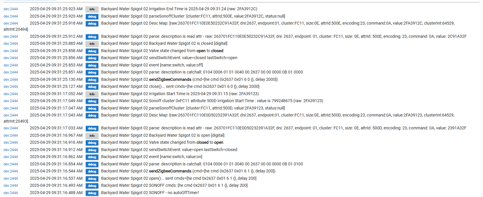

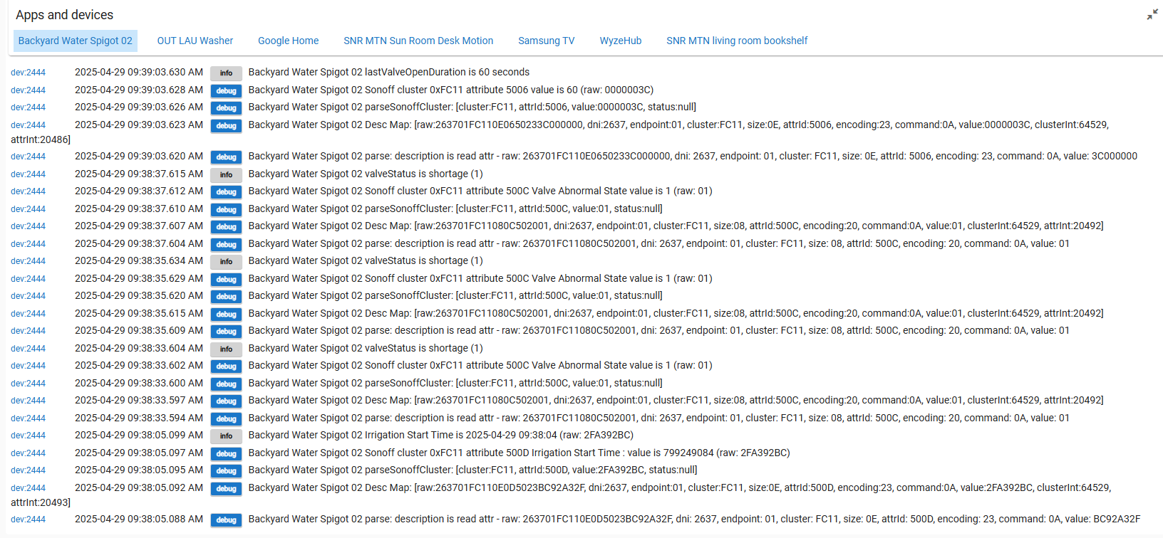

This is what a manual open / close looks like
This is what a digital open close looks like

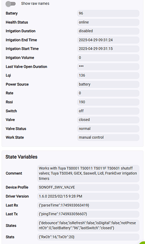

Device Commands
Device Details
Device Log with a turn on, then waiting for a natural device update/ checkin
Even after 2 minutes, still no update to switch or valve states
Would love to get this fixed, open to any ideas / suggestions.

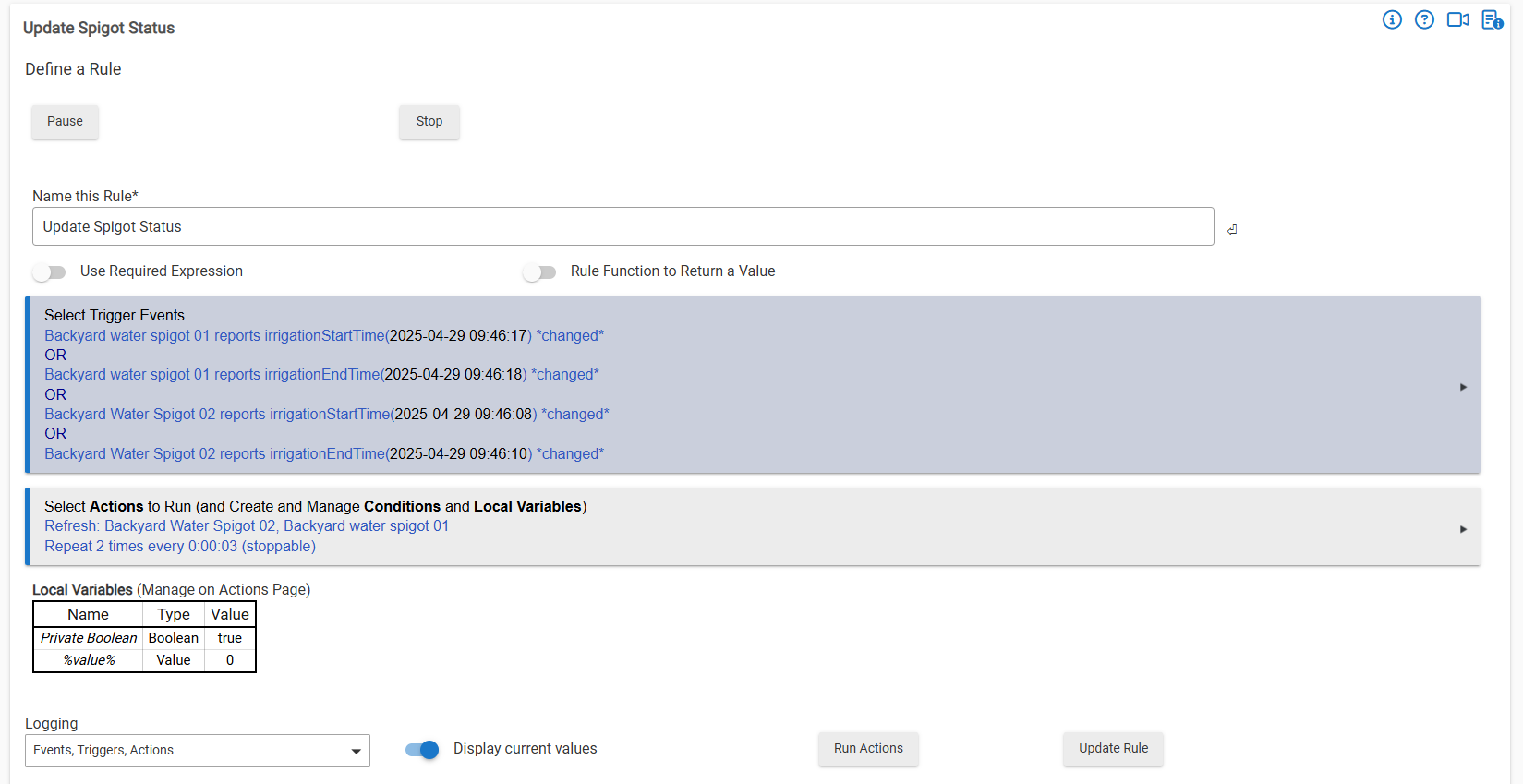

This is my workaround for now. Not ideal and noisy, especially once I get the rest of them in, but it works.
I'm sorry you are also have the same issue, but I'm also relieved, as obviously I am not the only one....Hopefully this can get fixed...
How does this solve anything, since the issue is the device does not report updated valve state when turned on/off via physical switch?
On my device, I observed that there is an update to the time values for the start stop of manual watering. By monitoring for any change to either of these values, you can trigger a refresh of the full device, which I found will capture the current state of the device, whether it is open or closed.
Ymmv

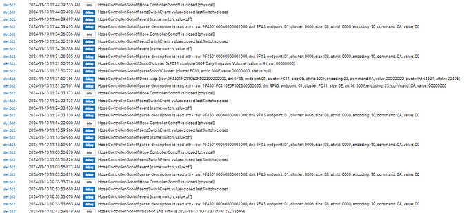

@kkossev Thanks for this. B-Hyve be gone. I just installed two of the Sonoff zigbee valves. First was recognized as device. Added the Tuya zigbee valve driver and it appears to work well. A pleasant surprise was when I added the second one it self selected the Tuya driver at install.
I had the exact experiance, second valve selected the tuya driver.
Any information about the "rate" state?
Sonoff water valve using tuya water valve driver by kkossev.
Works great, no rate.
There is a log entry per liter. Assuming it stays somewhat consistent you can easily calculate it for that particular use over a few minutes time span. On my sprinkler i'm getting roughly 8.3 L per minute.
Thank you, that is what i have done.

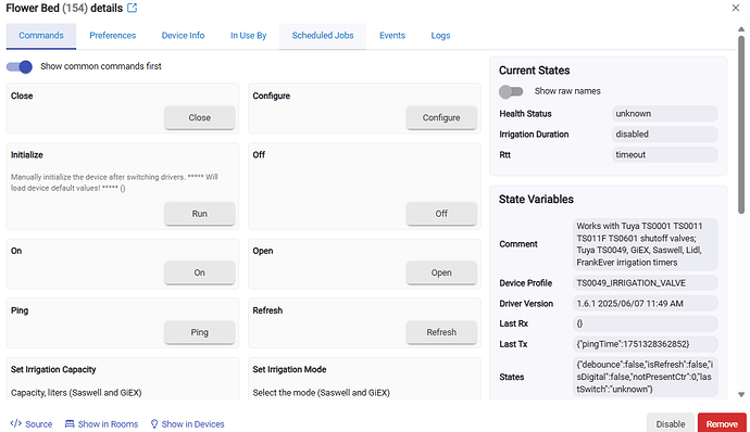

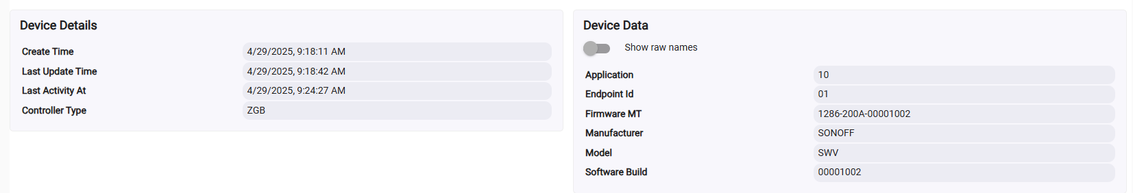

Here is a copy of the device info page.
Device Name Sonoff Zigbee smart water valve SWV
Device Label Flower Bed
Device Network Id 058A
Zigbee Id 44E2F8FFFE0C1C3C
Event history size 11
State history size 30
Too many events alert threshold 300
Type Tuya Zigbee Valve
Room Lawn
Dashboards None
Device Details
Create Time 6/30/2025, 3:44:45 PM
Last Update Time 6/30/2025, 8:06:02 PM
Last Activity At 6/30/2025, 8:06:16 PM
Controller Type ZGB
Device Data
Application 10
Firmware MT 1286-200A-00001003
Manufacturer SONOFF
Model SWV
Software Build 00001003

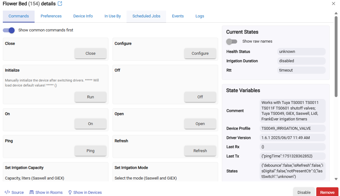

Below is the Commands page
Now here is a copy of my recent logs. What do I have wrong?

dev:1542025-06-30 08:05:24.168 PM
debug
Flower Bed refresh()...
dev:1542025-06-30 08:05:10.425 PM
info
Flower Bed Round-trip time : timeout
dev:1542025-06-30 08:05:10.422 PM
warn
Flower Bed no response received (sleepy device or offline?)
dev:1542025-06-30 08:05:04.536 PM
debug
Flower Bed sendZigbeeCommands (cmd=[he cmd 0x058A 0x01 6 1 {}, delay 200])
dev:1542025-06-30 08:05:04.534 PM
debug
Flower Bed open()... sent cmds=[he cmd 0x058A 0x01 6 1 {}, delay 200]
dev:1542025-06-30 08:05:04.479 PM
debug
Flower Bed SONOFF cmds: [he cmd 0x058A 0x01 6 1 {}, delay 200]
dev:1542025-06-30 08:05:04.477 PM
debug
Flower Bed SONOFF - no autoOffTimer!
dev:1542025-06-30 08:05:01.579 PM
info
Flower Bed Initialization finished
dev:1542025-06-30 08:05:01.564 PM
debug
Flower Bed sendZigbeeCommands (cmd=[he rattr 0x058A 0x01 6 0 {}, delay 2000, he raw 0x058A 1 0x01 0x0001 {10 00 00 21 00 20 00}, delay 100, he raw 0x058A 1 0x01 0x0404 {10 00 00 00 00}, delay 199, he raw 0x058A 1 0x01 0x0B05 {10 00 00 1B 01 1C 01 1D 01}, delay 200, he raw 0x058A 1 0x01 0xFC11 {10 00 00 06 50 07 50 0C 50 0D 50 0E 50 0F 50 10 50}, delay 201, he raw 0x058A 1 0x01 0xFC11 {10 00 00 08 50}, delay 202, he raw 0x058A 1 0x01 0xFC11 {10 00 00 09 50}, delay 203])
dev:1542025-06-30 08:05:01.481 PM
debug
dev:1542025-06-30 08:04:58.456 PM
debug
Flower Bed scheduleDeviceHealthCheck()...
dev:1542025-06-30 08:04:58.447 PM
debug
Flower Bed sendZigbeeCommands (cmd=[he raw 0x058A 1 0x01 0x0000 {10 00 00 04 00 00 00 01 00 05 00 07 00 FE FF}, delay 150, he wattr 0x058A 0x01 0x0000 0xFFDE 0x20 {0D} {}, delay 50, he wattr 0x058A 0x01 0xE001 0xD010 0x30 {02} {}, delay 251])
dev:1542025-06-30 08:04:58.393 PM
debug
Flower Bed setting powerOnBehaviour to last state (2)
dev:1542025-06-30 08:04:58.381 PM
info
Flower Bed configure()..
dev:1542025-06-30 08:04:58.297 PM
debug
dev:1542025-06-30 08:04:58.295 PM
info
Flower Bed Debug logging will be automatically switched off after 24 hours
dev:1542025-06-30 08:04:58.246 PM
info
Flower Bed Debug logging is true Description text logging is true
dev:1542025-06-30 08:04:58.244 PM
info
Flower Bed Updating Flower Bed (Sonoff Zigbee smart water valve SWV) device model null manufacturer null deviceProfile SONOFF_SWV_VALVE (driver version 1.6.1 2025/06/07 11:49 AM)
dev:1542025-06-30 08:04:58.241 PM
trace
destinationEP = 01
dev:1542025-06-30 08:04:58.239 PM
trace
model = SWV
dev:1542025-06-30 08:04:58.237 PM
debug
Flower Bed updateTuyaVersion() - not a Tuya device
dev:1542025-06-30 08:04:58.174 PM
info
Flower Bed deviceProfile was set to SONOFF_SWV_VALVE
dev:1542025-06-30 08:04:58.172 PM
info
Flower Bed device model SWV manufacturer SONOFF deviceName was set to Sonoff Zigbee smart water valve SWV
dev:1542025-06-30 08:04:58.159 PM
debug
Flower Bed FOUND exact match! deviceName =Sonoff Zigbee smart water valve SWV profileName=SONOFF_SWV_VALVE for model SWV manufacturer SONOFF
dev:1542025-06-30 08:04:58.155 PM
info
Flower Bed all states and scheduled jobs cleared!
dev:1542025-06-30 08:04:58.151 PM
debug
Flower Bed All child devices DELETED
dev:1542025-06-30 08:04:58.147 PM
debug
Flower Bed All scheduled jobs DELETED
dev:1542025-06-30 08:04:58.137 PM
debug
Flower Bed Deleted states: null
dev:1542025-06-30 08:04:58.131 PM
debug
Flower Bed Deleted attributes: weatherDelay, batteryVoltage, valve, switch, timerState, rate, irrigationVolume, timerTimeLeft2, valve2, healthStatus, rtt, irrigationDuration, valveStatus2, battery, irrigationEndTime, valveOpenThreshold, irrigationStartTime, timerTimeLeft, workState, valveOpenPercentage, irrigationCapacity, lastIrrigationDuration, checkInterval, lastValveOpenDuration, powerSource, rssi, waterConsumed, valveStatus, lqi,
dev:1542025-06-30 08:04:58.033 PM
debug
Flower Bed Deleted settings: forcedProfile (SONOFF_SWV_VALVE), logEnable (true), txtEnable (true), powerOnBehaviour (2), switchType (0), advancedOptions (false), autoOffTimer (0), autoSendTimer (false), threeStateEnable (false),
dev:1542025-06-30 08:04:57.973 PM
info
Flower Bed InitializeVars()... fullInit = true
dev:1542025-06-30 08:04:57.950 PM
info
Flower Bed Initialize()...
dev:1542025-06-30 08:04:55.895 PM
info
dev:1542025-06-30 08:04:55.893 PM
warn
dev:1542025-06-30 08:04:49.971 PM
debug
dev:1542025-06-30 08:04:49.970 PM
debug
dev:1542025-06-30 08:04:49.913 PM
debug
dev:1542025-06-30 08:04:49.911 PM
debug
dev:1542025-06-30 08:02:54.452 PM
debug
on()
dev:1542025-06-30 08:02:35.708 PM
debug
on()
dev:1542025-06-30 08:00:36.539 PM
debug
close()
dev:1542025-06-30 07:59:56.812 PM
debug
open()
dev:1542025-06-30 07:59:47.005 PM
debug
close()
dev:1542025-06-30 07:59:40.597 PM
debug
open()
Appears the SWV lost communication with the hub. Bring it closer to the hub and see if you can ping it and the health status changes
Is there a way to disable auto shut off of the Sonoff water valve after a water shortage exceeds 30 minutes? I'm using the Sonoff Zigbee Smart Water Valve with a low flow rate drip system and have been unable to get the valve to stay open for longer than 30 minutes.
I've been able to disable the irrigation duration option, but due to the low flow rate the rate appears as zero and the valve status is constantly showing as "shortage." Thus, the valve is closing at 30 minutes.
I’ve tried different drivers, including Tuya and Sinope, with no luck.
Checking in here after a year or so. Still have a HomeKit problem where it doesn't recognize when the valve has turned itself off via the inbuilt timer. HomeKit still shows the valve as on. I'm using the latest kkhossev Tuya Zigbee Water Valve driver. Is there any known working config at this time?
Just tested mine and it is working as expected (auto off set to 10 seconds, but shortened the Gif..)
Is the auto-closed state updated correctly on HE dashboards?
