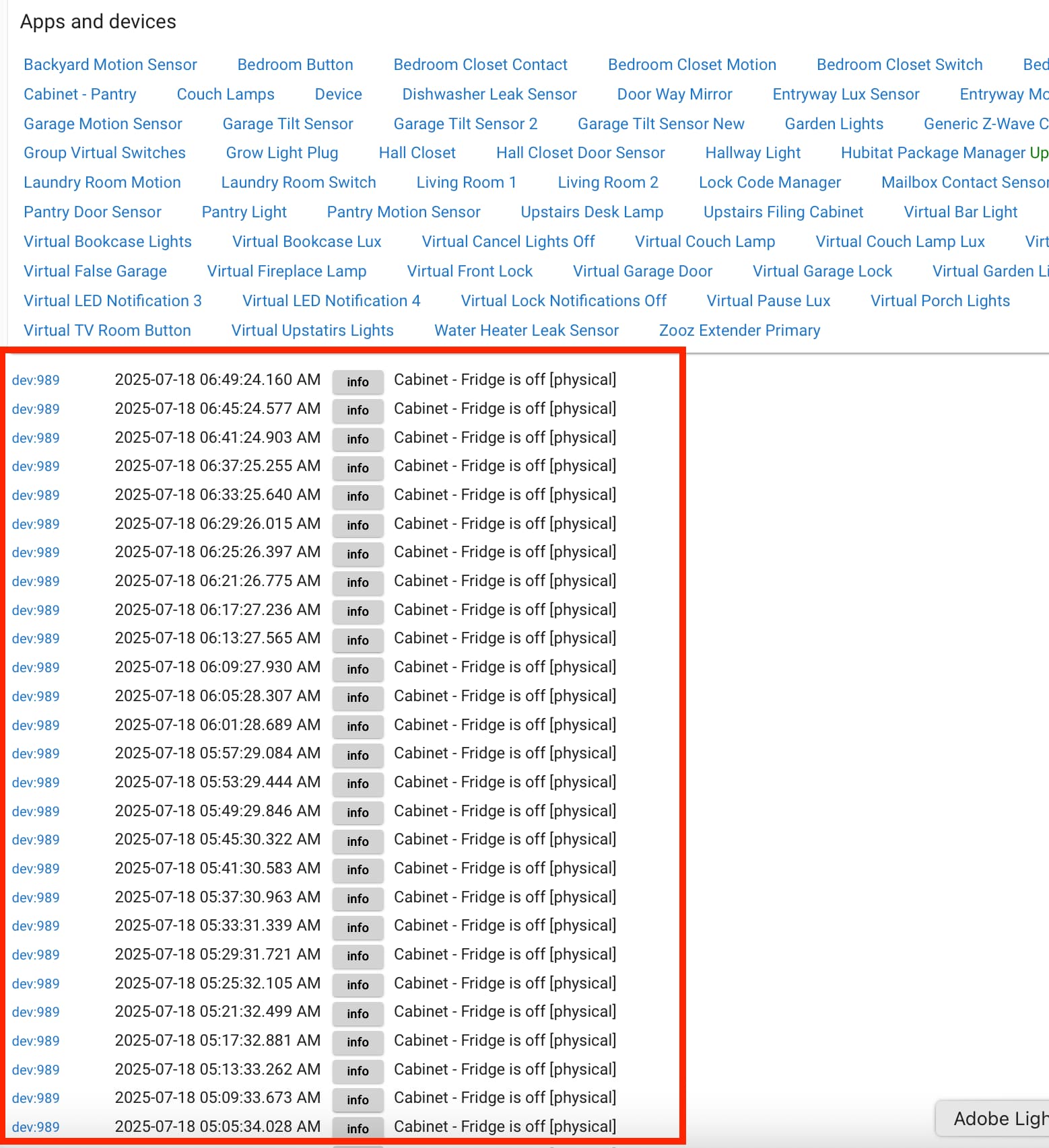

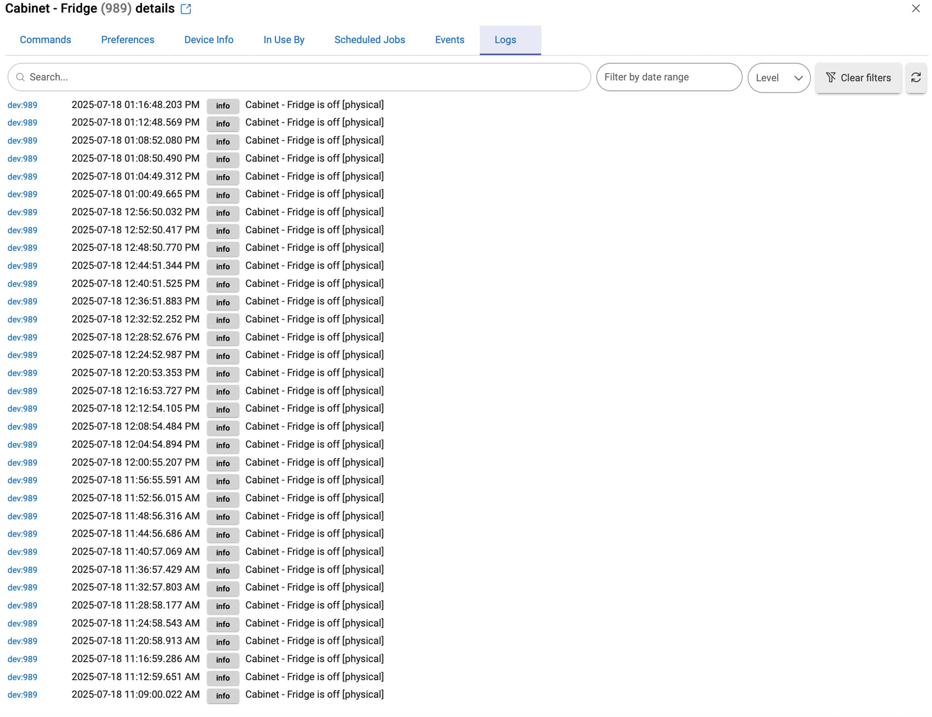

I just noticed that the ZBMini is generating a log entry every 4 minutes. I have 3 of them, so it gets to be quite "spammy"! I can't remember if this is the way it has always been or is recent. Anyone else seeing this? Is there a way to stop this?

Devices do not usually just post their current status like that without a reason. Something is trying to turn it off every four minutes.

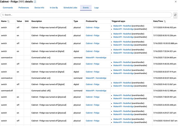

You can see what is trying to turn it off in the event tab of the device.
Nope. I have a bunch of those. They all do that every 4 minutes.

Interesting. So what does the Events tab say it is produced by? Just the device itself?
Edit: It would have to be the driver causing it, if it is from the device. Have you tried this driver instead>
No event. Just log info entry.

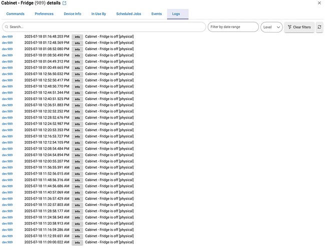

The event logs are pretty clean and show the actual activations. The logs, on the other hand, are completely different. I believe the driver generates the log entries, but don't know for sure.
Events:
Logs:
:flushed:
Yeah - that's the same for me.
