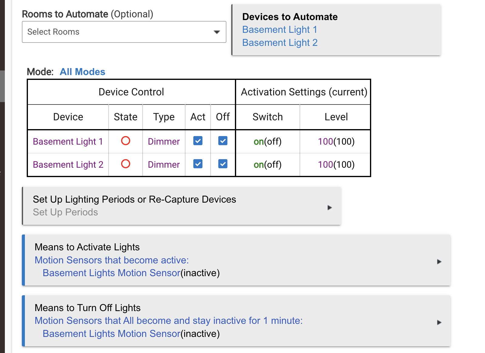

Trying to setup a Sonoff SNZB-03 motion sensor to turn some lights on/off.
I have a C8 Pro, trying to setup the SNZB-03 with Sengled RGB bulbs.
I have followed a couple of forums and still cant get the device to actually turn lights on or off.
I've tried the Generic Driver, the Sonoff Driver by Markus, and the Tuya 4 in 1 driver but none have worked.
Using Room Lighting and can't get it to ever work.
Currently have it on the Sonoff Driver by Markus, attached is a screenshot of current status and the Room Lighting setup.
What am I doing wrong?

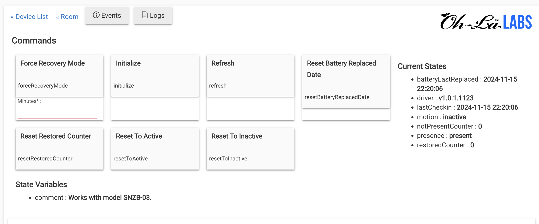

Is the motion sensor working? Does the 'motion' attribute change from inactive to active when there is a movement in front of the sensor?
Check the Events and the past Logs (click on the two buttons on the top of the device web page).
Not seeing any event logs other than when I tell the device to do something (using the device page to reset, etc.).
Just walked by it to try and activate but no events.
Is it just a bad sensor?
Most probably the device is OK, but it has failed off the Zigbee network.
Pair it again, close to your C-8 hub.
Use this driver from HPM.
Works fine for me.
Wyn, did you manage to keep this sensor connected to your HE hub?
If not, you can try this workaround.
Thank you for all the advice! I tried multiple times with your instructions as well as different drivers, however I could not get the sensor to stay connected. I had another motion sensor to spare, so I followed your steps again and the new motion sensor seems to be working flawlessly. We'll see if it can stay connected for longer than a a couple of days though.
