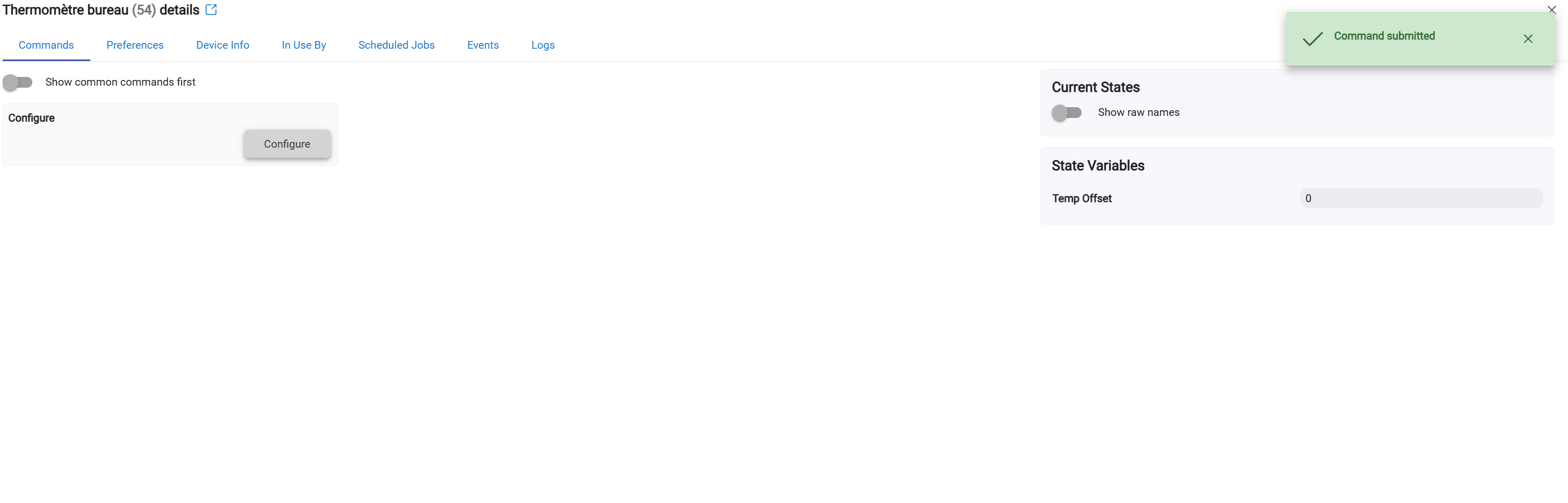

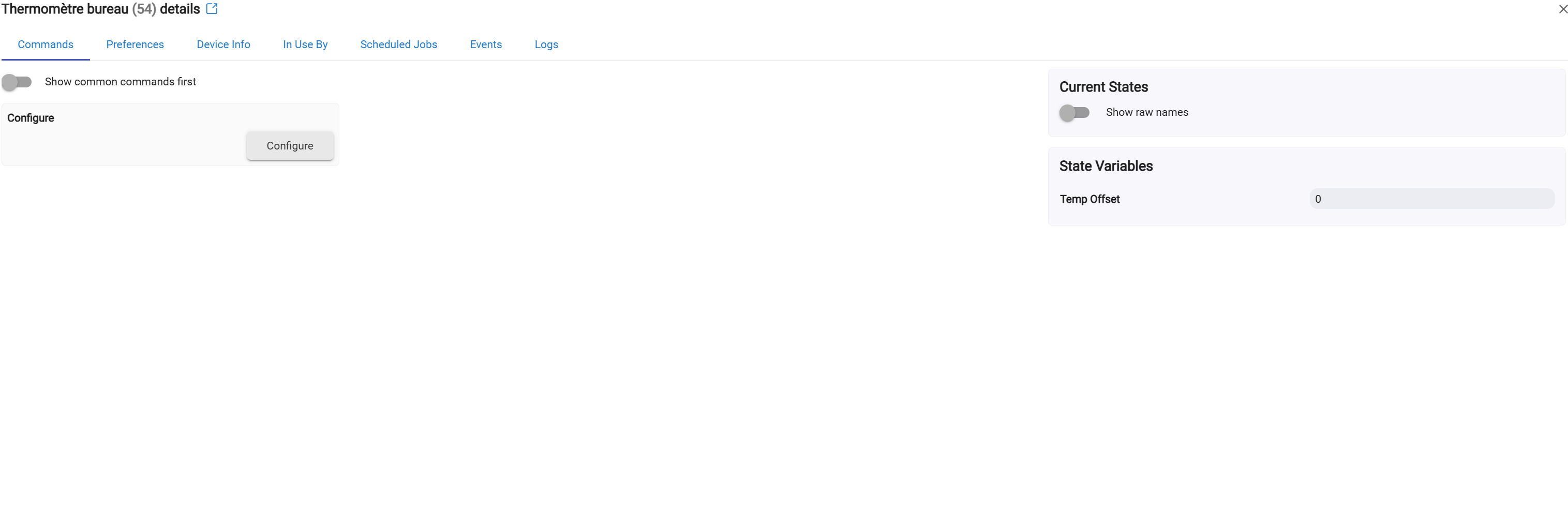

i cannot see any device states
Did you hit Configure on that page?
yes and each time i hit configure i see this on the right corner

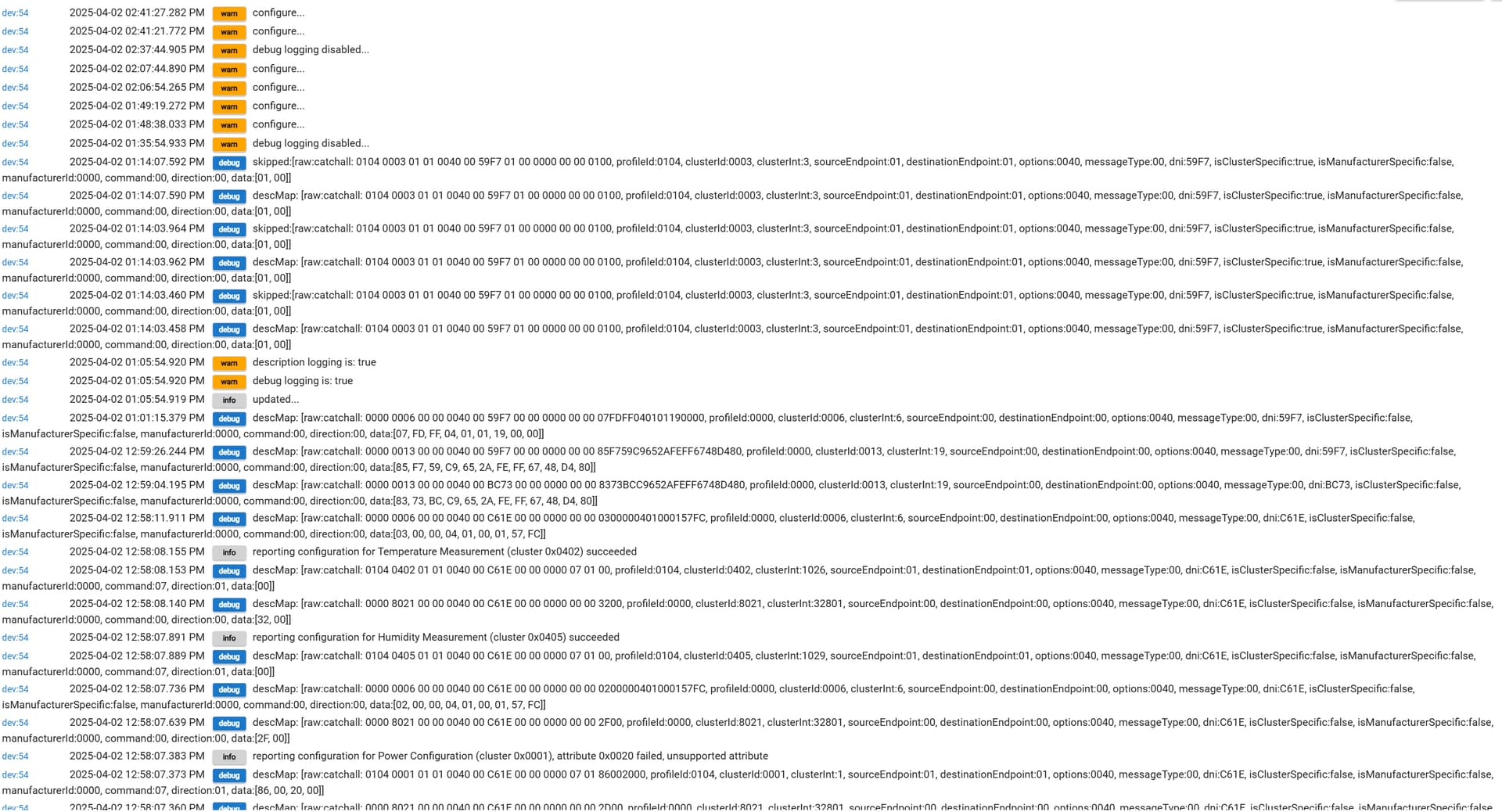

OK. Hit the Logs tab and please post a screenshot of that.

Note that attributes will not appear on the command page until you close the driver page and re-open it. Also, dashboards do not get new attributes after they are created unless you refresh the dashboard.

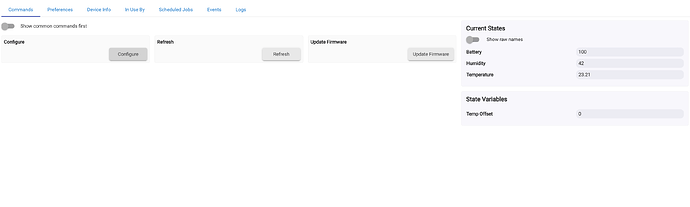

i just unpaired and paired again with the new platform version

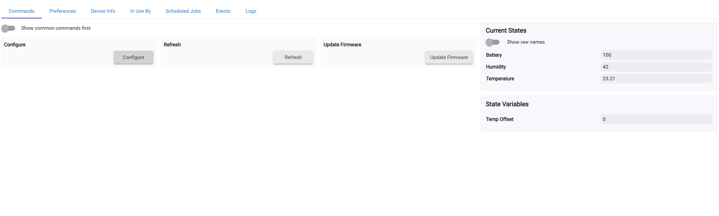

and I can already see the values in the command ''current states'' tab

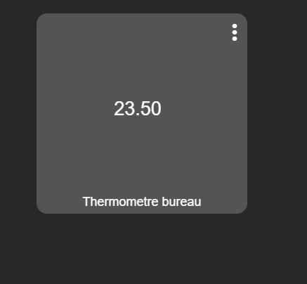

and i can see as well the temperature on the daashboard

is there anyway to see silmuntaneously temperature/ humidity and battery on the dashboard on one tile only ?
Not using the default dashboard tiles.

I have similar sensor and I handled it differently - and can get both temperature and humidity on 1 tile. Under Templates, instead of choosing an Attribute, further down the list is Humidity - and Temperature - and Weather. A Weather template (note - not an attribute but a template) will give you both temperature and humidity readings, but unfortunately some other stuff too. I think it took some work to make it display nicely.
