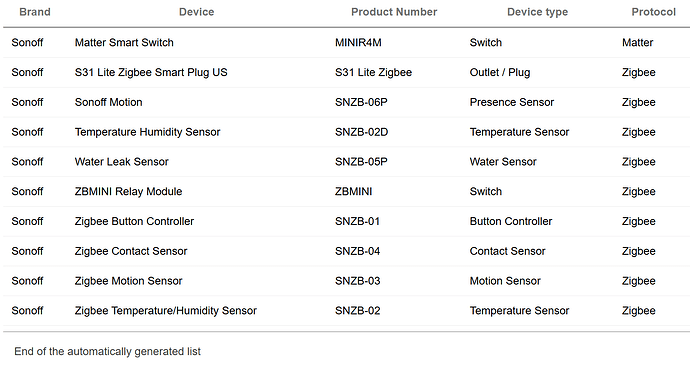

Which list is the SNZB-01P on? :thinking:
Supported Sonoff

You're correct, my bad.
I didn't realize these were two different devices, SNZB-01 and SNZB-01P until I got further into the forum.

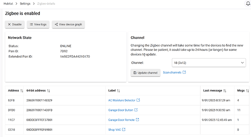

I was all excited early this morning to try your "Voodoo" process for pairing problematic devices to Hubitat. Unfortunately, I hit the proverbial brick wall early at step 2. On my hub (C7), there is no "Rebuild Network" button to press. Here's what I see from your step 2.
The other steps in your suggestion I've done numerous times successfully but not changing outcome. Anyway, I pissed more time on this (about 2 days) than I ever thought was necessary. Then I started picking up on some other things in your response.
