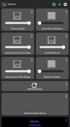

can you post a picture of how the tile shows up on the dashboard?

Dashboard tile looks like this, clicking the icon toggles open/close and the bar lets you select a position.
