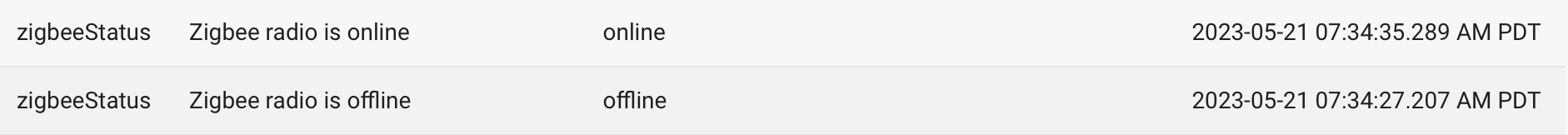

I'm sure this is some kind of weird coincidence, but I had a zigbee radio on/off at 7:34 am.
It will be really interesting if I get another one at 10:00 am. (It's just 8:30 am here.)

I’m runnng 2.3.5.146 on a C-8. I added a rule to notify me if the radio goes offline. And I am getting multiple notifications a day, sometimes multiple notifications in quick succession.
Checking logs I see no evidence of an errant device. I only have 18 devices. I have been slowly unplugging devices but the issue persists. Any suggestions? Thanks.

When you say occasionally what do you mean? My radio has gone offline 5 times in the last 12 hours. Am I to assume that this is normal and I can just ignore it if it doesn't impact normal operations?
I spoke too soon. I just got a notification that the radio went offline. I tried turning on a device through Sharptools and it failed. I checked the zigbee radio status and it looks like it came back online and then went offline again. I see this a lot - sometimes going offline 2-3 times in succession.
