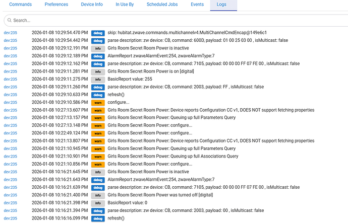

Well...Darn. I tried it on a Zooz ZEN32 and a GE (Jasco) Smart Motion Switch. No effect. He problem persists.
ZEN32:
Jasco Z-Wave Motion Switch:
It may be worth mentioning, on the ZEN32, I tried configuring with both the System Driver as well as the Community Driver linked on the Zooz website.

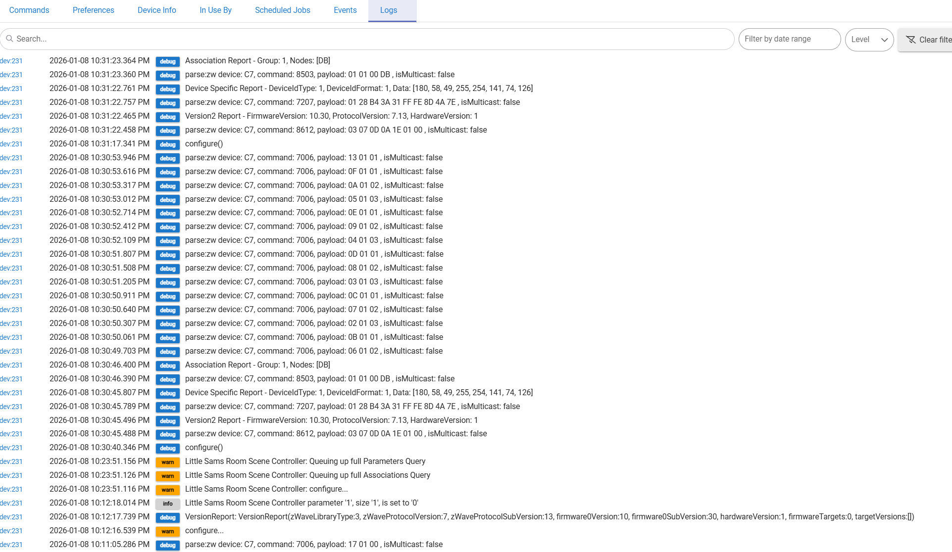

Did you run the "Lifeline Association" command button with my scanner driver? That is the one I know for sure will fix it. I don't see anything about lifeline in the second screenshot
On your first screenshot I can see your lifeline is screwed up.
I am guessing you somehow set one of those USB sticks your paired as the lifeline for every single device.... Just checked, you sure did, here is your lifeline, so the devices are/were sending their reports to this node:
