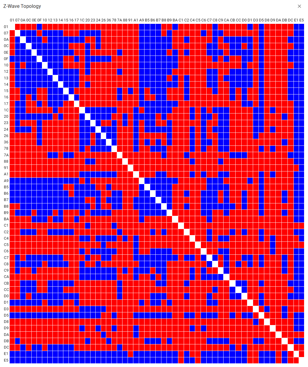

Especially need both of the screenshots mentioned below. There is something I have in mind that would be revealed by the red/blue topology map.

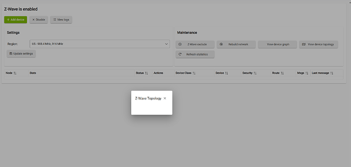

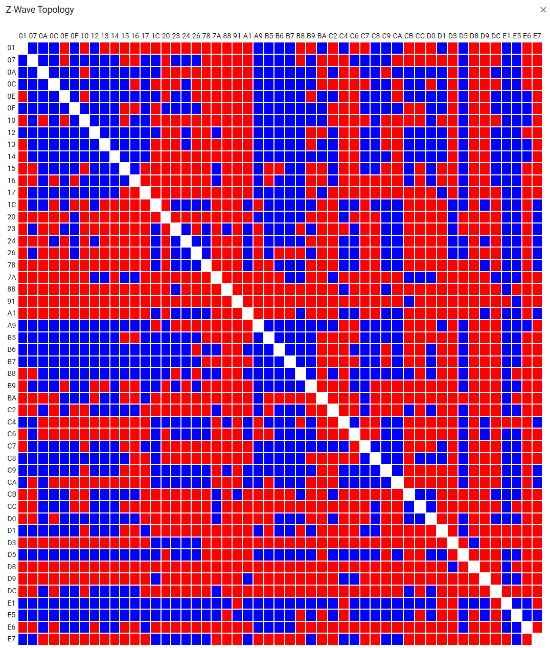

  • Z-Wave Topology Map:
Thank you again for your help. Please let me know if I screwed something up or you need anything else.
Ok, see all the ones with blue in the 01 row and columns? Those are the only devices where the hub and device think they can talk directly to each other. All the other devices would need to route through those devices to reach the hub. Does that seem correct? You can match the hex node ID up with the device in the details list.

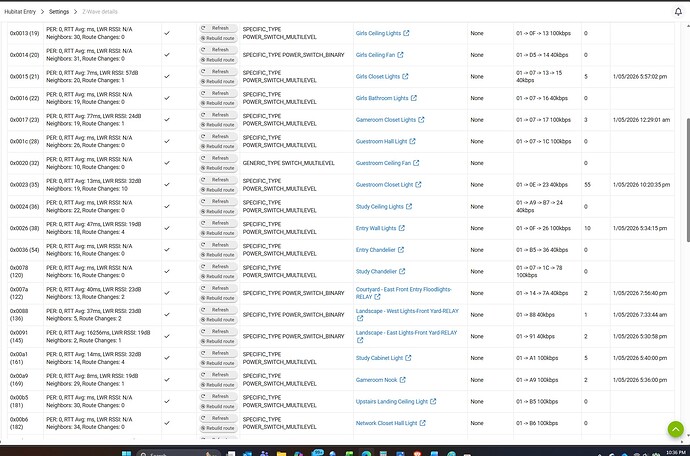

Also the zwave details you sent me in a PM, you either did not refresh the stats or it was taken shortly after a reboot I think? All the RTTs are blank. I guess maybe that would make sense if the radio is totally locked up.

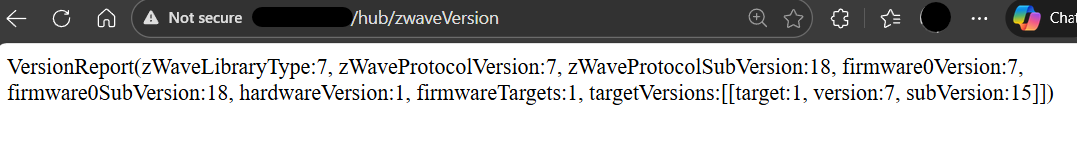

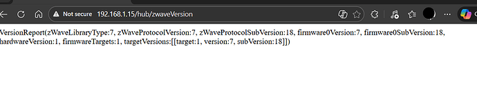

For Zwave it looks like you have the radio firmware updated but are still on the 7.15 SDK. You can follow these steps to be sure its all updated. The Update Firmware button will be hidden if the radio firmware is already up to date. In that case just run the gateway update endpoint and reboot.
Thanks for the explanation of the device topology. I think graph tracks. My hub is in a network cabinet, inside an a/v closet. Devices 07 and 0F are Z-Wave switches that flank that closet. So, it is not altogether surprising that those would be the most leveraged final hop in the routes.
As for the RTTs, I did press the "Refresh Statistics" button on the devices page prior to grabbing that screenshot. At that time, it had been about 16 hours since a reset. After i saw your comment, I pressed it again to be sure. One device popped up with an RTT. I pressed it again and a few more populated. I pressed it several times and I ended up with this:

So I was able to get install 7.18:

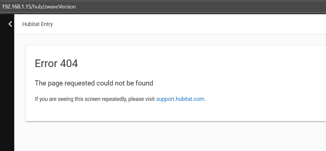

However, now when I reboot, all of Z-Wave is gone:

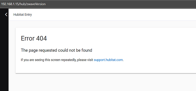

And, when I try to check zwaveVersion, I get this:
Any ideas?
Found this. Going to try it.
That brought the Z-Wave back (I was sweating for a minute). But the original problem remains.

Looking in your details list, I see a lot of devices trying to route through things that no longer show the hub as a neighbor. This could be where its getting all jammed up.
Keep the hub outside of the cabinet. Try running repair on just node 0x0007. Then you could also try running it on a few of the other devices near the hub that should work as repeaters to the hub. Wait a few minutes and refresh the stats. See if the topo map shows any new blue marks on 01.

I think we may have been going in the wrong direction, however your mesh does look a lot better now!

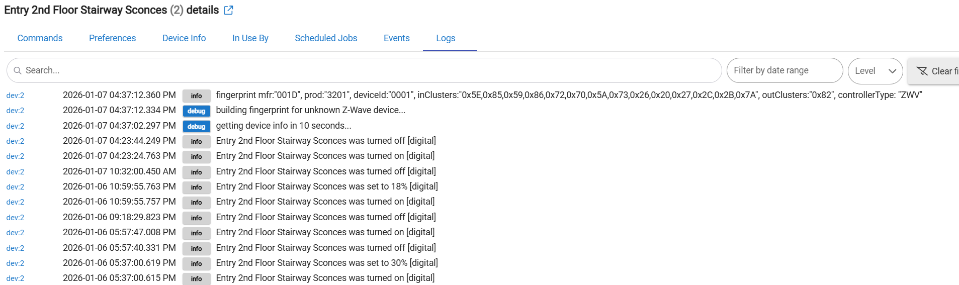

You can also switch one of them to the "Device" driver, enable debug if its an option. Then try activating the device and see if anything gets logged. Post a screenshot of the logs.
Depending on those things, I have one other idea that the lifeline association might be lost which would be very odd. If you turn on debug logging on my Leviton driver and then run the Configure command, it should try to set the Lifeline association if its missing, so you can try that also. The debug logging will show you in the logs what it did exactly.

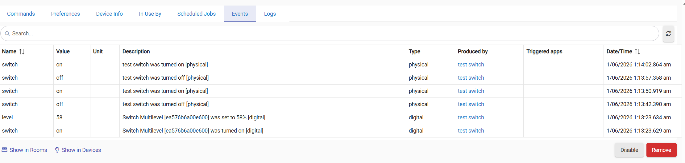

Holy s**t it worked! I checked two separate devices, just to be sure. You can derive from the logs (from the lack of "Physical" activity before) that it did require running the configure command.
I switched a different switch to the "Device" driver and hit configure. Here is the output from that:
