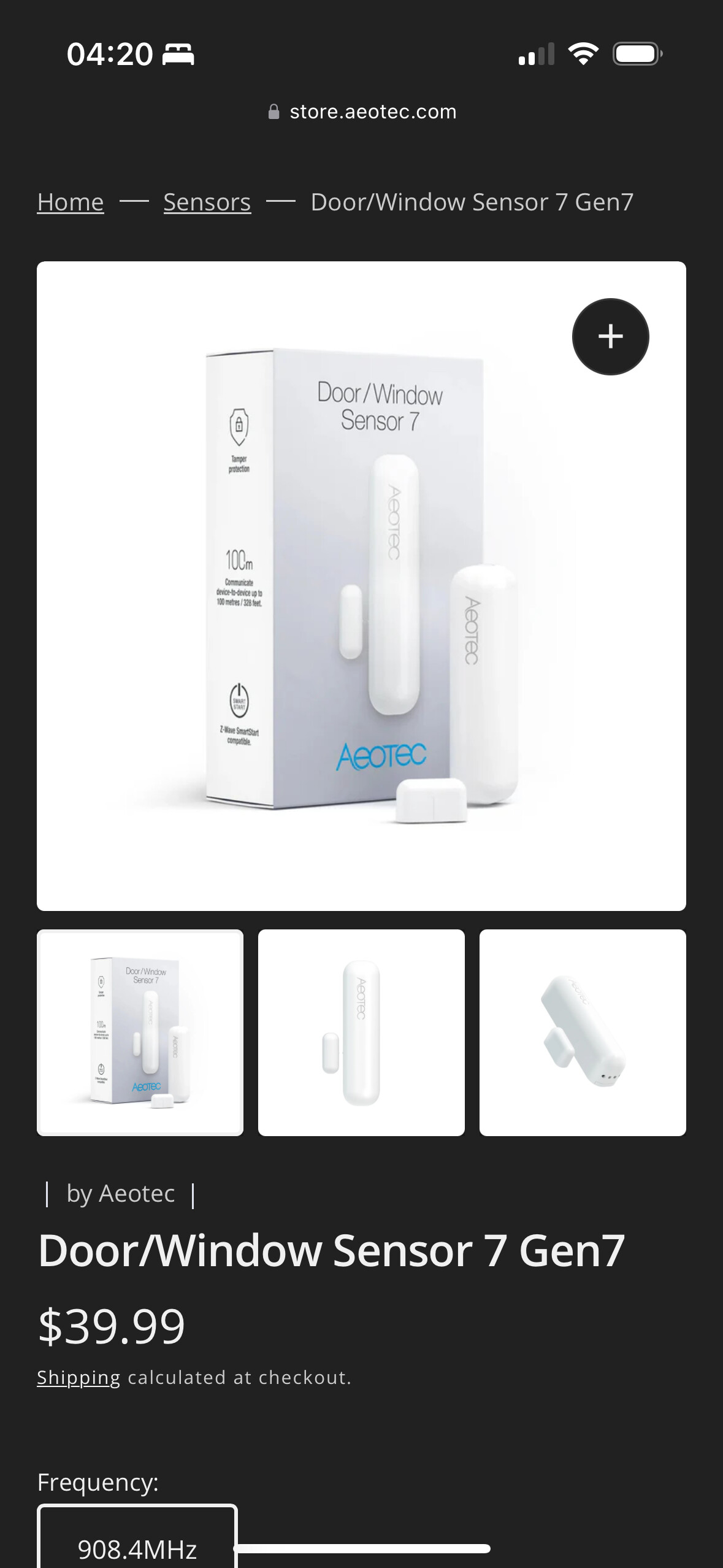

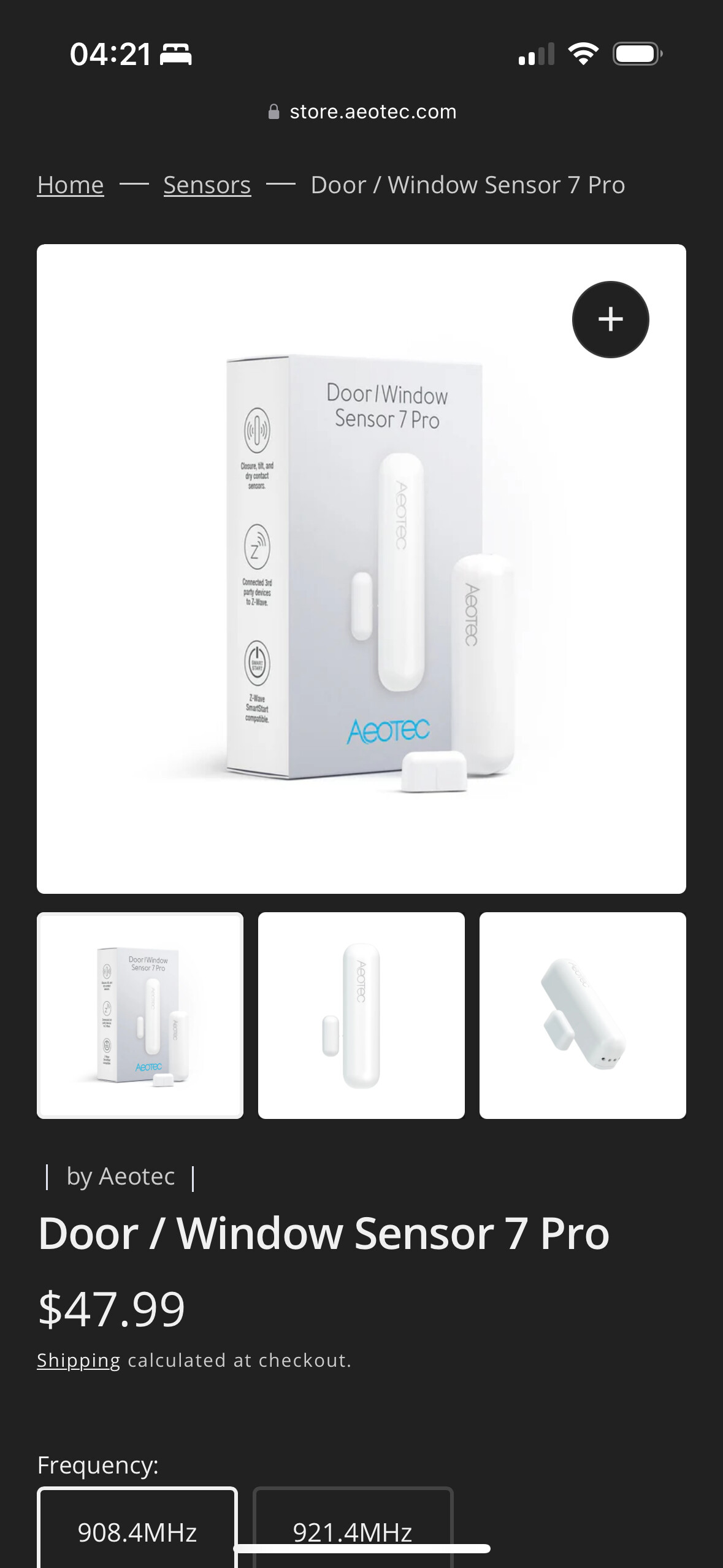

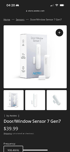

This sensor doesn’t have dry contacts. Only the Aeotec Door/Window Sensor 7 Pro does. And the Pro version of the sensor has screw terminals - no soldering necessary.
The manual you linked to is specific to the Pro version.
Also, it is very simple to manually turn on dry contact mode in the Aeotec Door/Window Sensor 7 Pro. I used this sensor in my previous house.
Which one do you have?

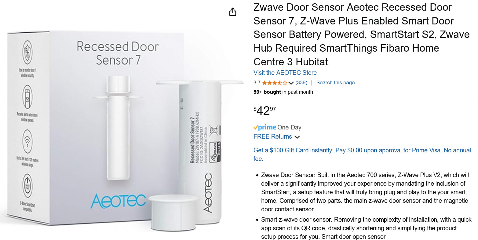

or
Ahh - I don’t know anything about the recessed door sensors.
I have several of them and I love them. I mainly use them for automatic lighting, such as in closets. Yes, an expensive option for such a simple task. :slightly_smiling_face:
My bad: I have the non-Pro/basic model, and I just confirmed with Aeotec support that it does not support dry contract usage. I’ll be getting the Pro verson…
