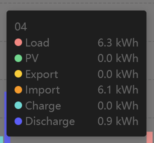

I understand that you would like to have the accumulation of watt/hours for the 24 hour period beginning at midnight today. However, is this the total load (home) use, the total grid draw, the total solar production?
I did a couple of calculations and looking at the realtime query parameters, I'm pretty sure that "e-today" is just the total solar production for the day - which might explain why mine is at 0. There are other "e-today" parameters defined in other queries. I'm guessing that total solar generation (aka PV) is probably the most valuable number to a majority of users?

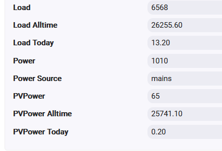

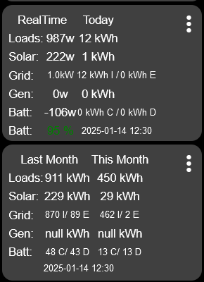

I have an updated version in HPM if you would like to test it out and give me any feedback. Same name, author is StarkTemplar, newest version should be 0.4.8.
The only existing attribute name that changed was Power to Load. So you may need to update your dashboard if it references the Power attribute. There are also 2 attributes you can use for an already made dashboard with multiple fields - ComprehensiveTile and MonthlyTile. Add CSS on classes solarSmall and solarDate will help make the text smaller on some of the large fields.
