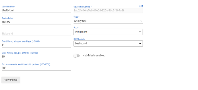

I jest got mine in. Now how do I wire it up to my 12v battery's? I jest got my Shelly Uni in today and jest tried to setup in hubitat. I testing by using by on/off but it is not working.

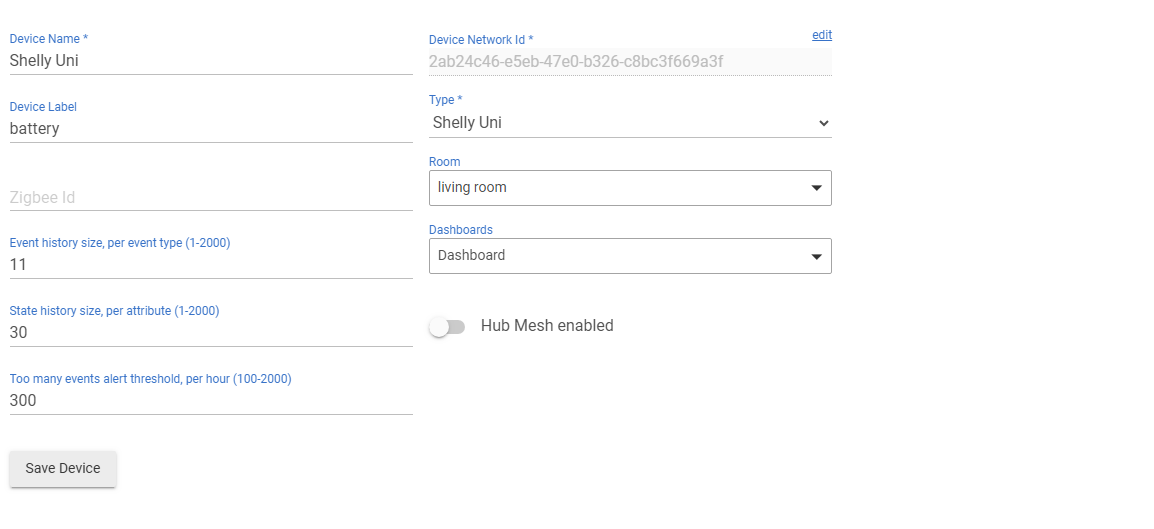

Can you show a screenshot of your Hubitat configuration?

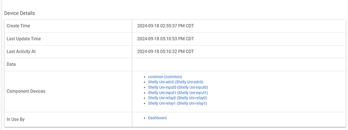

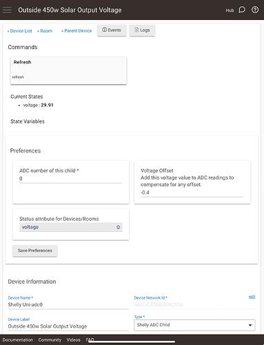

You need to go to the « Shelly Uni-adc0 (Shelly Uni-acd0) » device in order to see the voltage:
