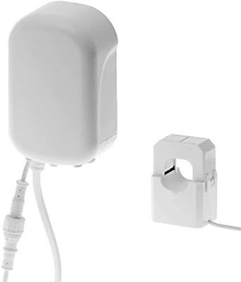

So what HEM are you using for that?
I managed to get some of these before they went out of stock
These are the details and model number if you can find one.
MAX 60A, 1 Phase, 260V~.
Model Number:DSB28-ZWEU(868.42MHz),
input: 230VAC, 50Hz, 10Ma
Then I converted a driver to do things like send me a summary of usage once a month.
Unfortunately, the driver does not work on the later HEMs
You need a single phase, single clamp HEM but I don't have a working driver for one apart from the one above.
If you can find a working driver in the community then I can add my extra bits to it for you.

@Cobra Thanks for all the info Andy. Vesternet have these on sale ending today but I can't see the exact model number. Do you know if this will do what I want or is this the newer version?
As it's z-wave plus, I would suspect that it is the newest version.
Geoff, there may be a community driver for it, but I just don't know
It appears to be the same as this one..
Have a look at this thread..
Andy
Thanks again. I've just found the exact same model as yours DSB28-ZWEU(868.42MHz) on Ebay, so I've jumped on that .
