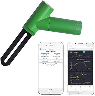

Anyone try these?
They may work with other Fine Offset bridges such as Ambient Weather or it may be possible to extract data from their bridge via Weewx. They are low cost and IP66 rated. Even the bridge is not that expensive, so I don’t mind if I have to install yet another bridge to get what I want from another IoT device. I don’t see any reference to an API, so I’m curious if there’s another way.
