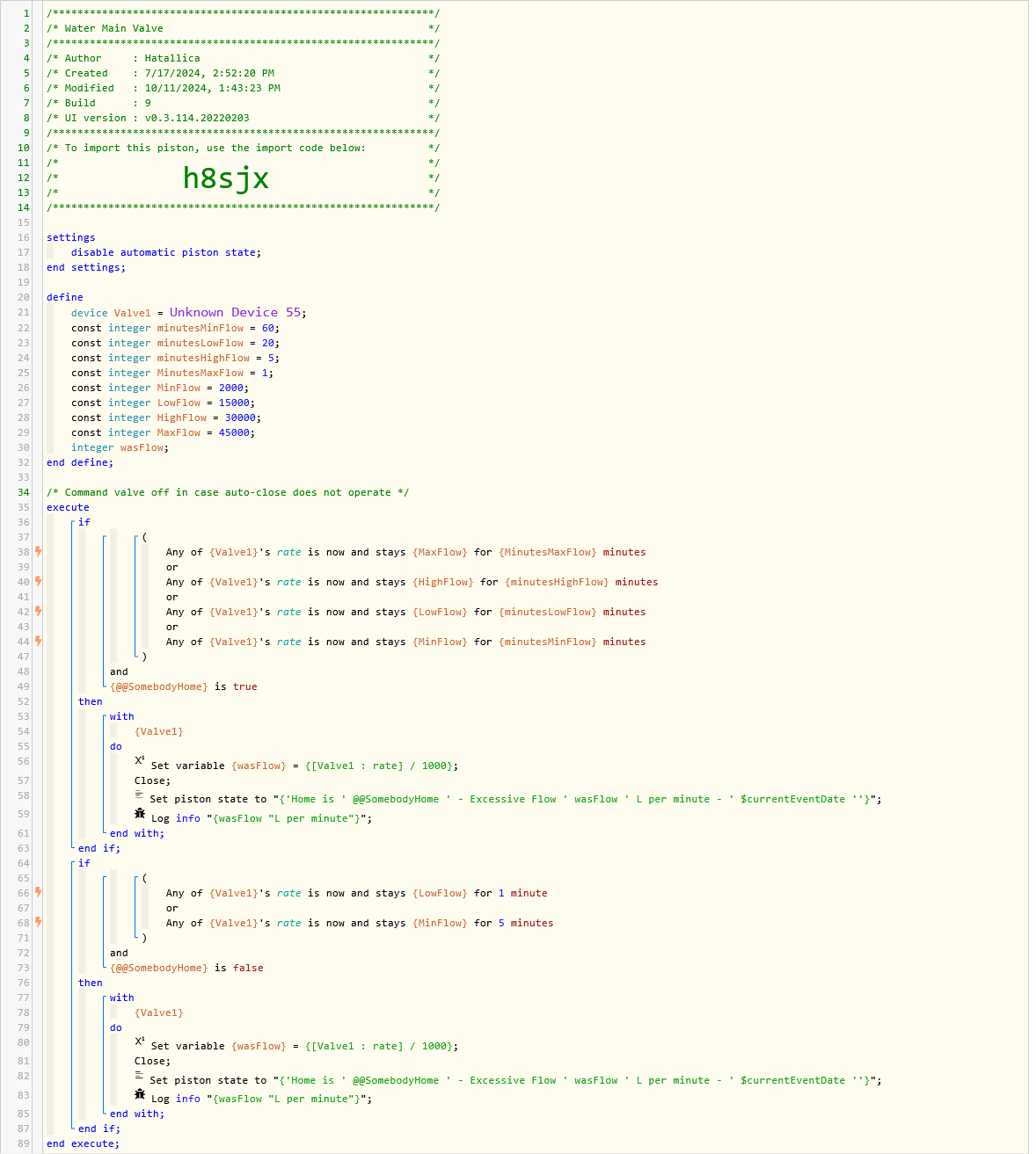

Using the Sinopé for a while and recently caught an annoying toilet malfunction. My rule is nothing fancy - just setting flow limits for 1, 5, 20, and 60 minutes. Make sure that you include a notification method, so you are alerted to the valve closing.

Here is my simple scheme (with flow units in milliliters):
Piston
