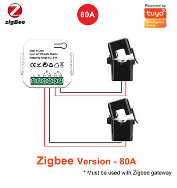

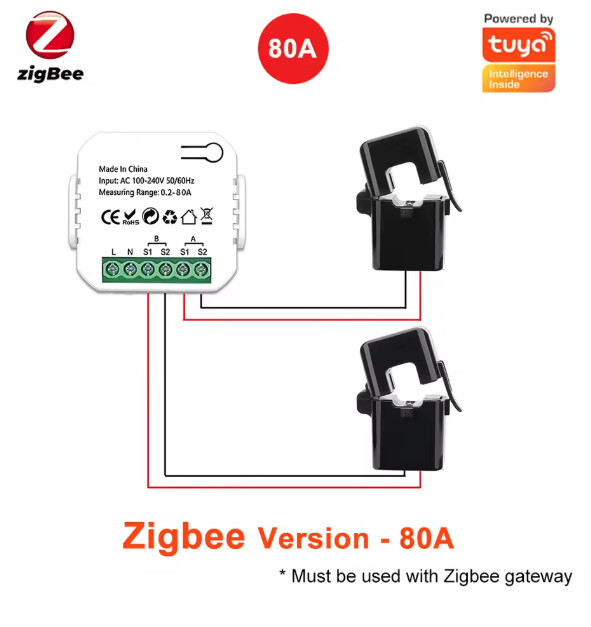

Another is the Tuya Zigbee clamp option.
But be forewarned:
