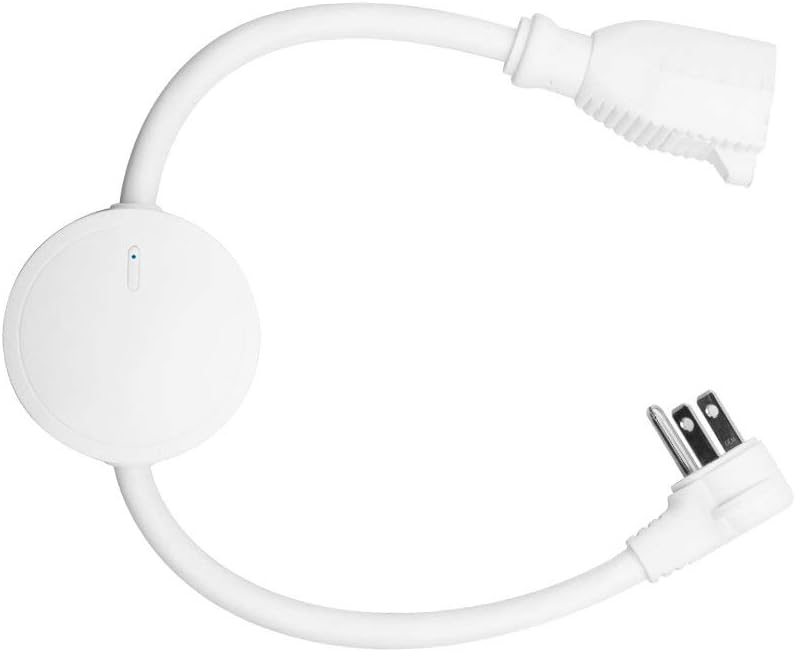

Well, I have one spot where I wanted only to increase the Zigbee mesh.
So, I used the following device, and it seems to work well (so far):
