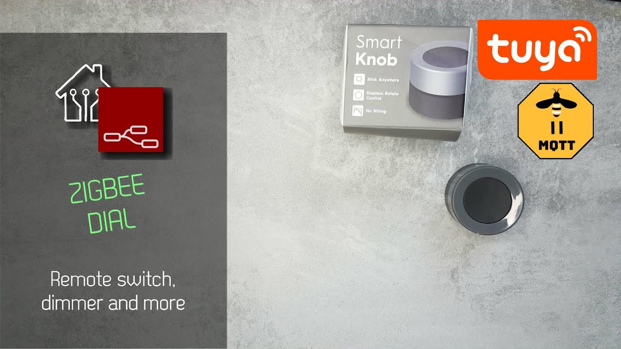

If anyone else is curious about this interesting product, here is a pretty good demonstration video from a few months ago.
Looks pretty neat to me! I kind of want one to play with. But I'm not sure how I'd use it. Maybe for dimming some lamps. It would be nice to use for blinds or fan speed.
For smooth dimming (press and hold and then rotate) this device will not work very well in HE , but works just fine for step-changing the brightness (by 10% for an example), or for switching scenes, etc... Be aware that there is a 1-second delay between rotation events in one and the same direction. Should work without any issues with controlling blinds or switching fan speed, which are relatively slow processes.
