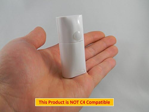

You can find these on eBay...Iris motion sensors, 3326-L. Fantastic. Small, fast, dependable.
The next gen is a little bigger but adds humidity reporting: IL07 3rd gen. The pic below is not to scale w/the one above.
It's just a little bigger. I just bought some of these, $13 each, free shipping.
The above is Zigbee so won't work either. You are less likely to find small Z-Wave motions sensors becsuse until recently, the protcol needed more power than Zigbee, so coin-cell batteries and others without larger capacities were not feasible. The Ring Gen 2 motion sensor uses the current 700-series Z-Wave and, I think, coin cell batteries, or at the very least is a lot smaller than the last generation. However, it requires S2 so will only work if you have a C-7 hub. More may come to the market at some point, but that's the only one I know of now.
