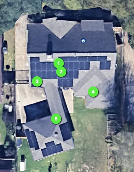

I think your biggest problem is just a lack of devices that repeat. That appears to be a large area (couple thousand square feet?) with just a smattering of repeating devices.
You can either start adding more switches, which can smarten up other areas of the home, or go for a repeater. The downside to a dedicated repeater is they don't do much except repeat, but you can sometimes place them to get a better signal and/or move them around more so than you can do with a switch.

Thanks for all the information guys! referencing this picture
1 being the hub
2 - Light switch that has never had issues
3 - Light switch never had issues
4- Newly added switch, endless issues
5 - Light Switch never had problems
Clearly, if it must be the 4th light switch I added that is causing these problems. Correct me if I'm wrong, but the C5 has zero way of me actually troubleshooting any of these issues?
