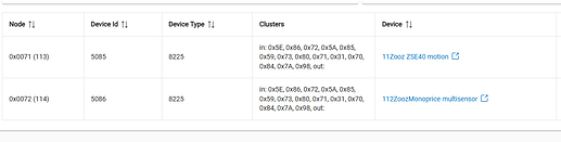

Won't do any good on a C5 guys, that detail isn't there. Only the C7 and C8 give that full chart like you are used to seeing.
This is what you see on a C5.
That is what I was worried about. Are ghosts as likely on the zwave 500 chip.

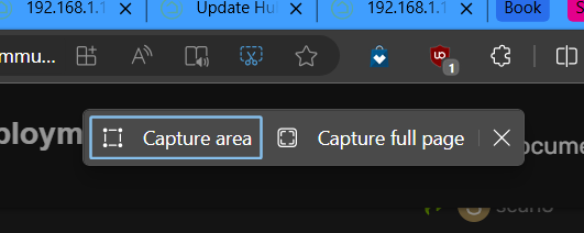

I know this is a super late response but the below tip is applicable in a lot of circumstances.
If you're using Edge browser you can capture a full page by selecting Screenshot off the "..." menu on right.
Very handy for capturing web pages in one go.
