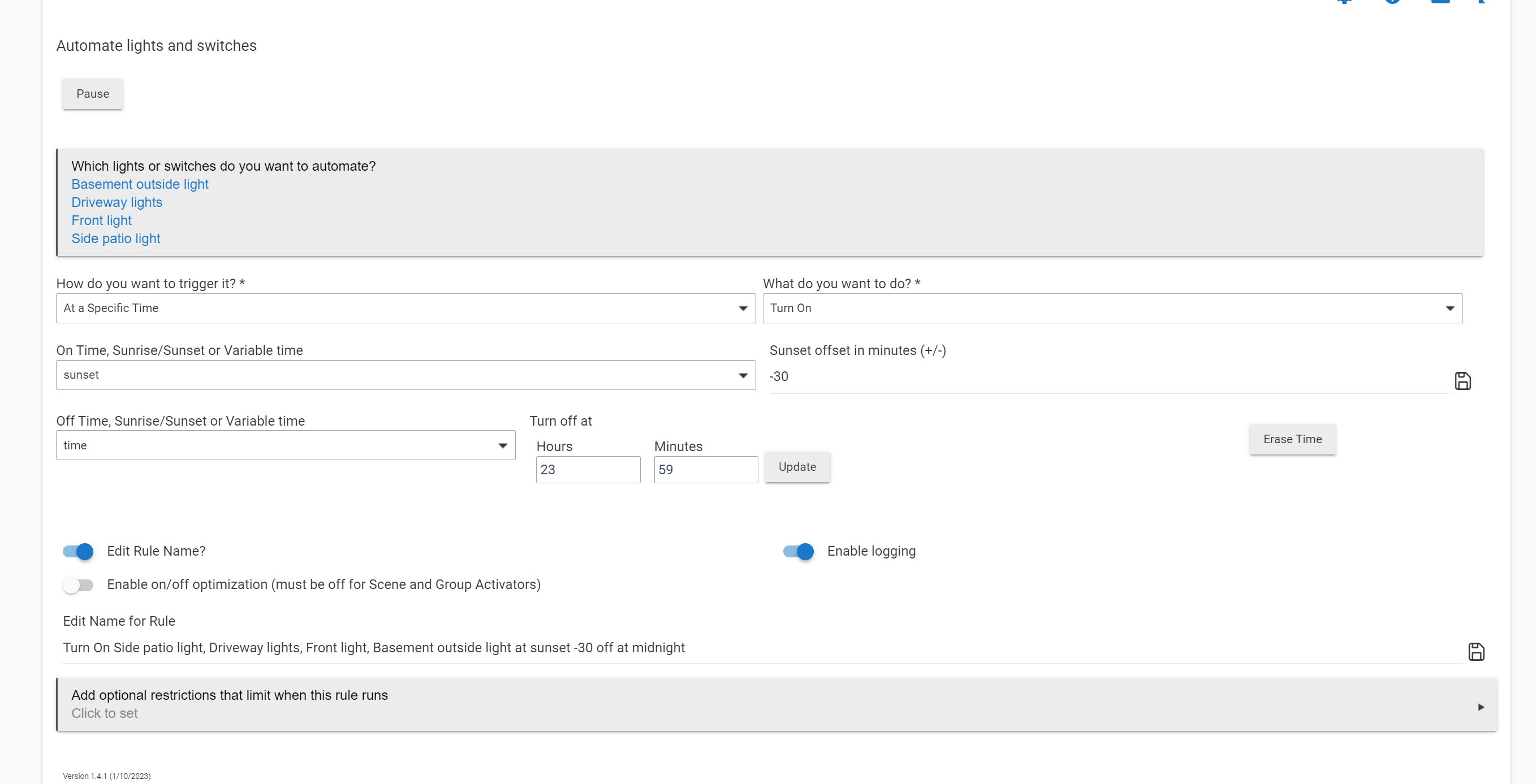

So I did the export/import and it kinda worked for a bit and now this week the outside light rule and the foyer light rule (both of which are basically turn on a device at 30 mins before sunset and turn off the device at either 23:00 or 23:59 depending on the rule) just simply do not turn on the devices. It's a mixture of Z-Wave and Zigbee devices. ALl of the devices work from the hub if you manually choose them, but none seem to work via the rule. Am I doing something wrong? This is VERY frustrating to have something work without having to think about it for months and now I cannot get it to work consistently.
Have you updated to 2.3.7? There was significant memory improvements in that build. Then you can also do a reboot with the "Rebuild" option selected to rule out any database issues left over from 2.3.6.
Also, show us the rule.
I have seen in the past rules with waits in them fail on the second part when the hub is overloaded with poorly coded wifi drivers / apps that keep hammering TCP connections when devices are offline. Usually this generates a lot of errors logs. So it would also be a good idea to review the past logs, you can even filter it to warn and also error, to see if anything stands out.
