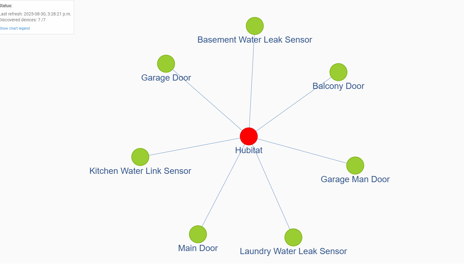

The colors on the zigbee map app show signal strength

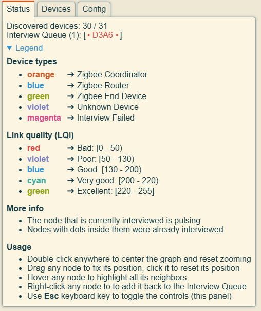

If is green does it mean devices have a good strength?
Click on show chart legend for an explanation.
This is the one I was referring to.
The stock zigbee map does not show signal strength.

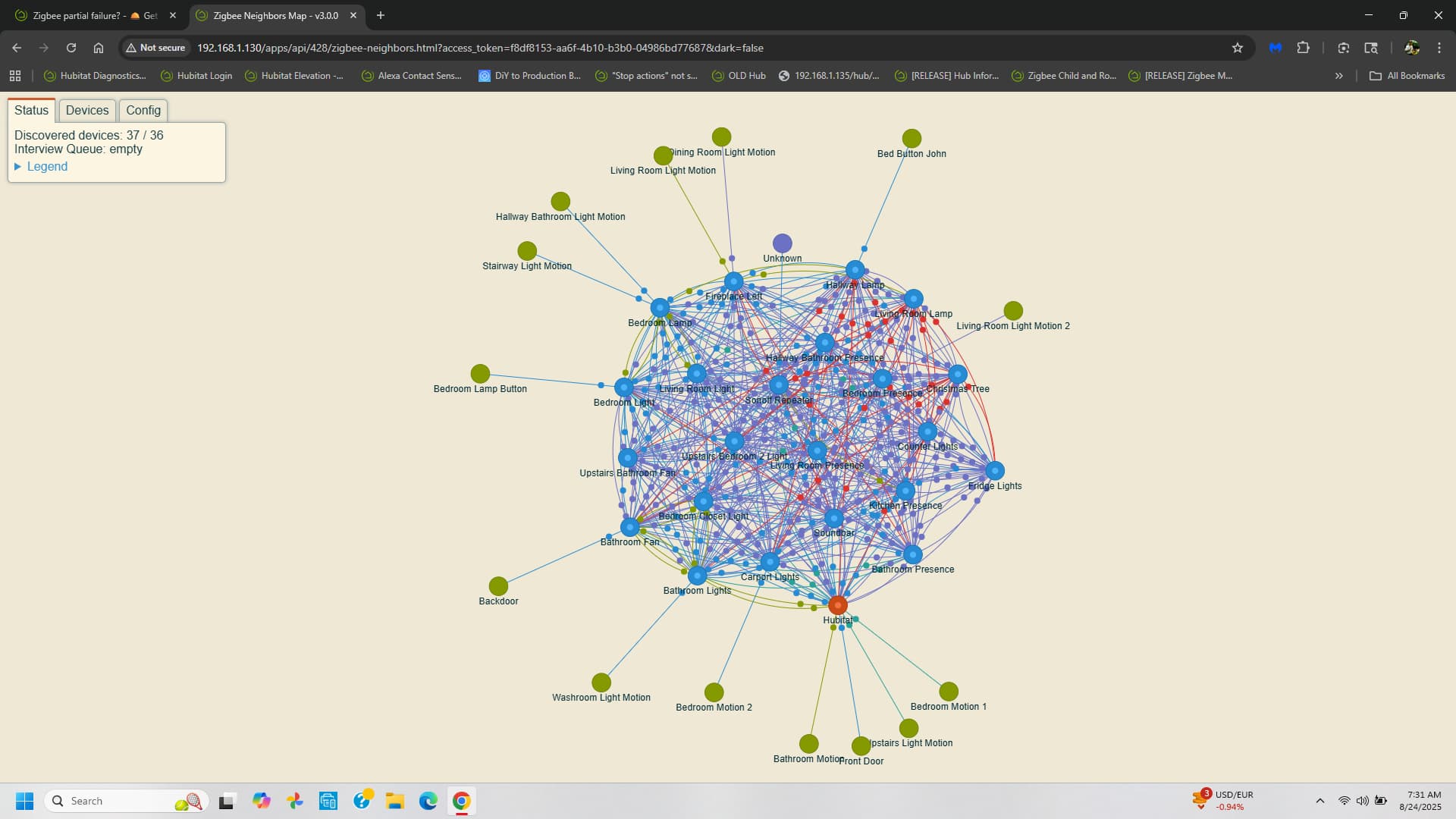

The community "Zigbee Map" app does indicate relative signal strength, but I wouldn't rely on it for any big decisions. The zigbee devices I have out in my detached garage all show "Bad" signal connections in that map, but they've all been performing flawlessly out there for years now.
The best thing you can do for your mesh (especially zigbee) is make sure you have repeaters well-positioned to help the battery-powered devices.
