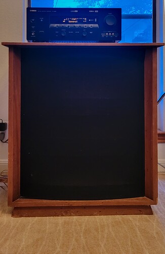

Yamaha and pair of Altec Valencias.
My daily listeners.

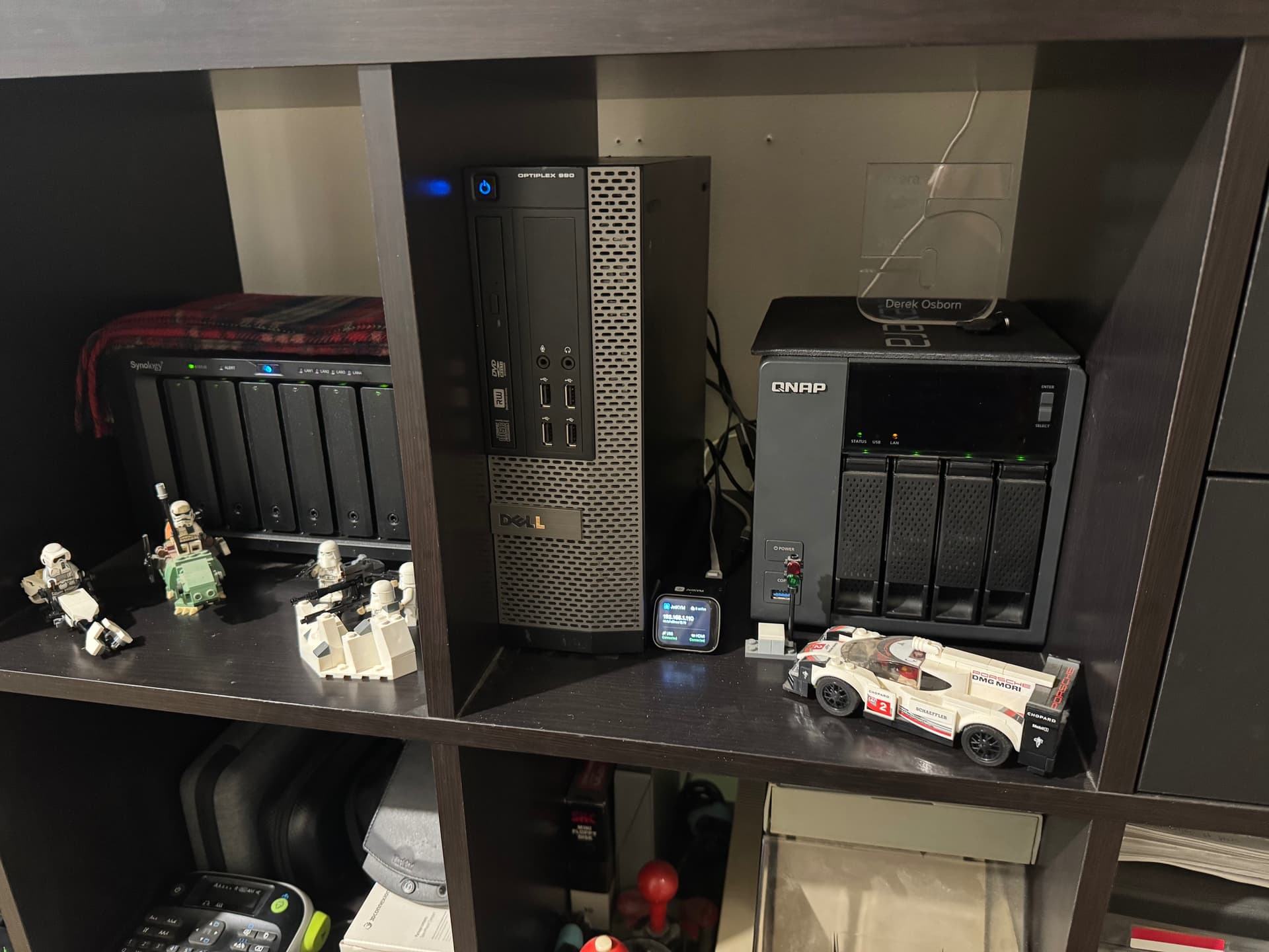

My Rack got a minor upgrade this week, I added a 2nd NAS (QNAP TS-453a) that was a work freebie. I had 20TB worth of misc sized disc lying around and shoved them all in as a JBOD volume, and my Synology DS1621+ can now be fully backed up.
I also mounted my switches on a horizontal shelf so I could fit the cheap 2.5Gbe x8 + 10Gbe x1 Managed network switch, I ordered, in (hasnt arrived yet). I have a bunch of new Cat6 network cables coming this week so I can tidy things up a bit more - the Hubitat & Hue network cables are too short for my new arrangement, and many of my cables are aging cat5.
One day I will finalise my cable management.... (more than I already have...)

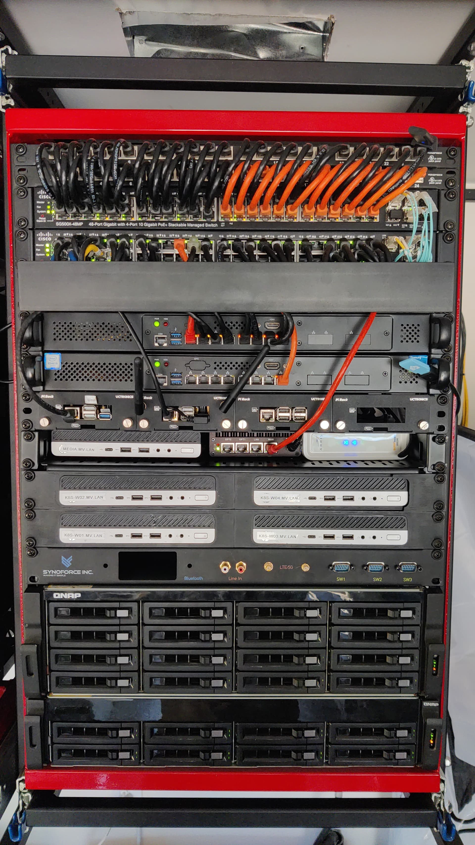

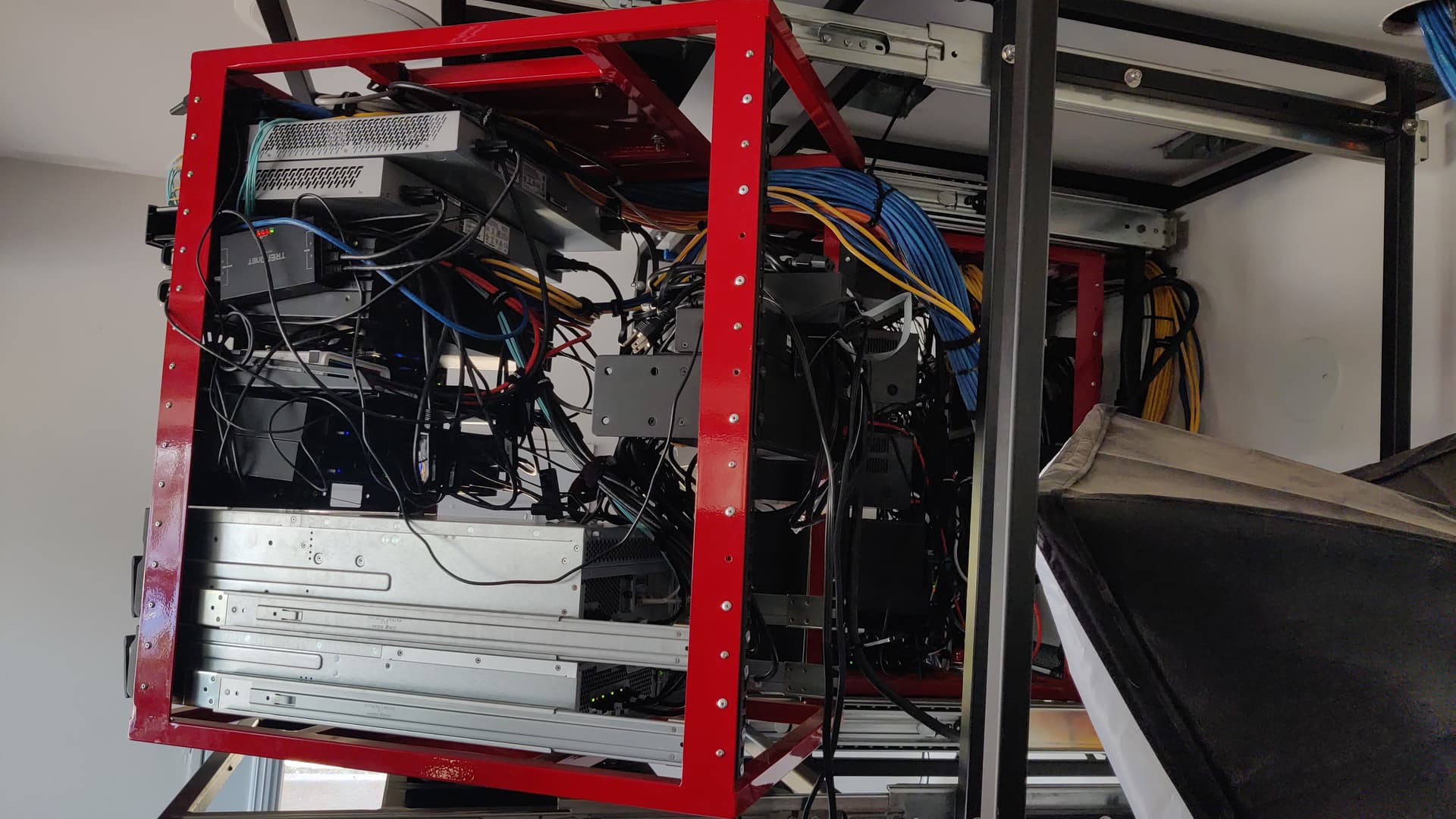

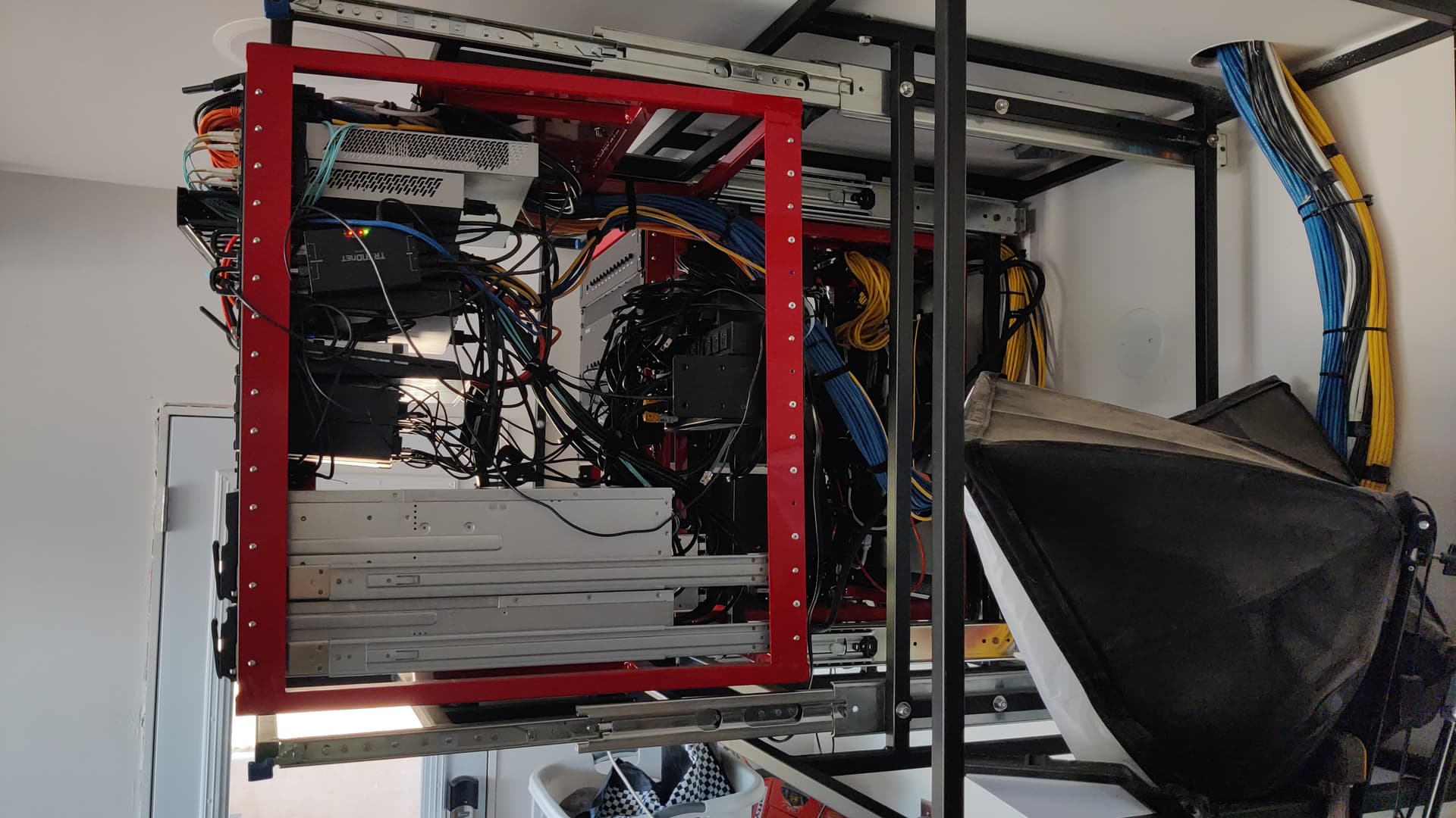

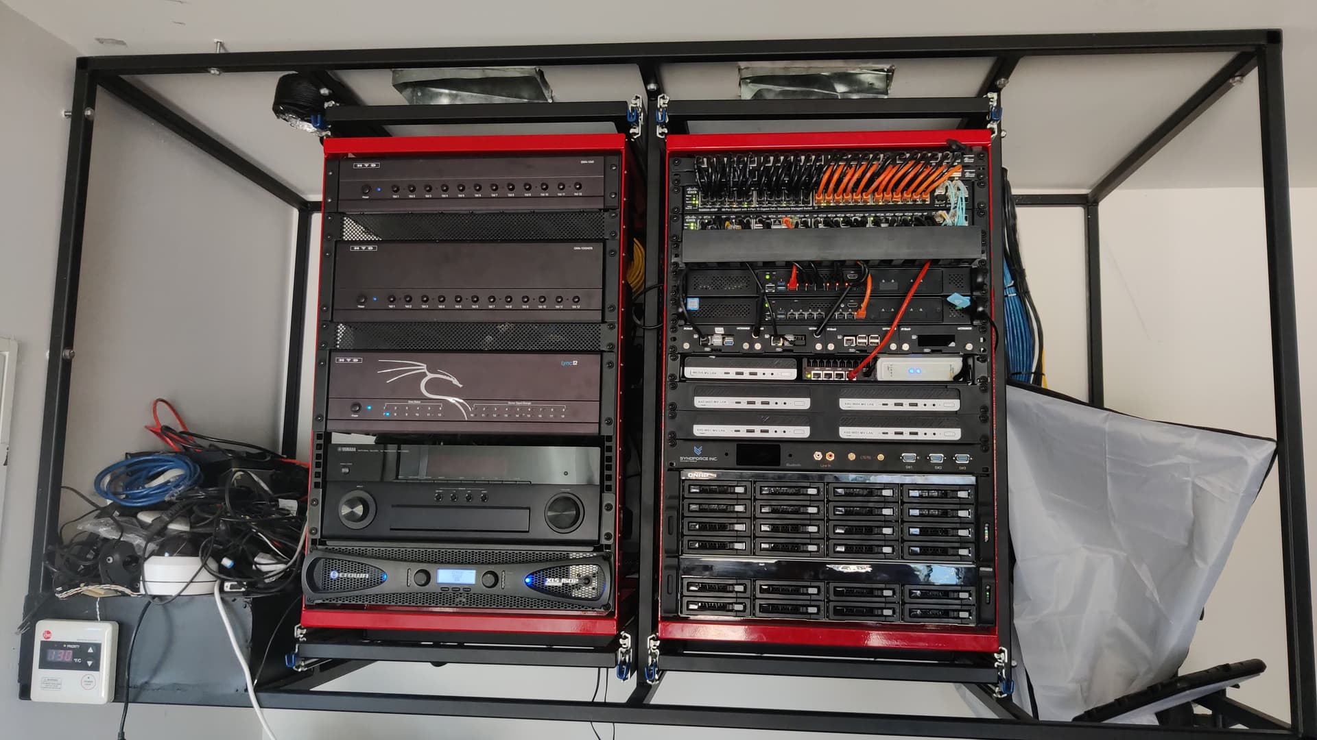

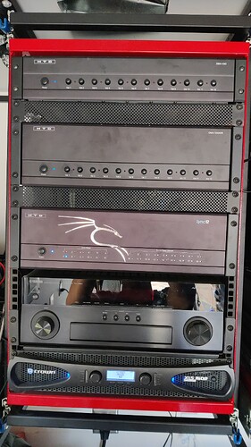

Here is my custom-built rack in my garage. I still need to build a cabinet around it.
I can pull it out and swivel it to access the back of the equipment.

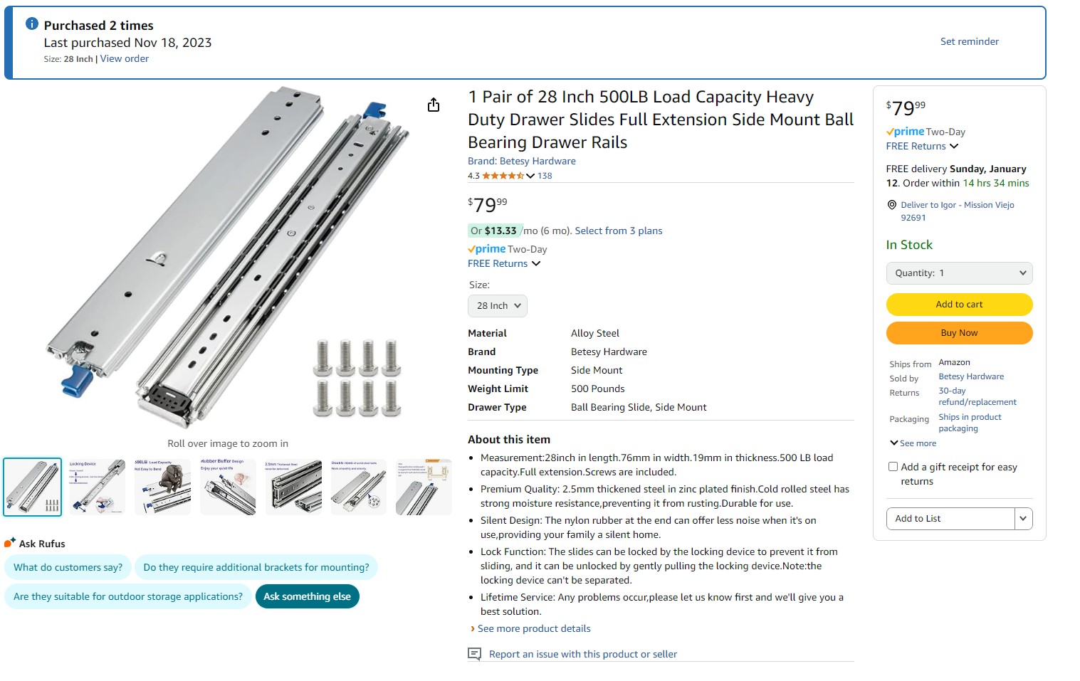

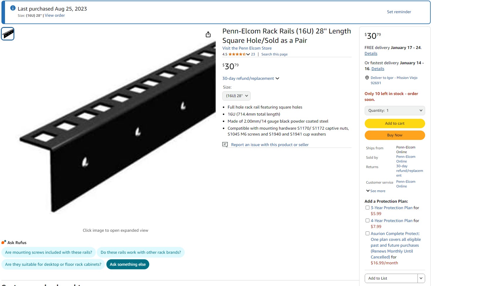

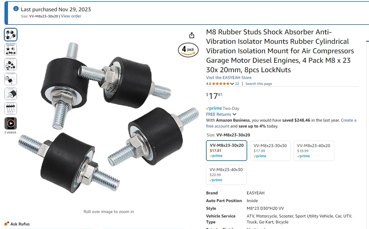

Please share what type of hardware you use to allow this to be pulled out and swiveled around to access the back....
That's probably what Jeff Bezos's garage looked like just before he decided he needed bigger premises..

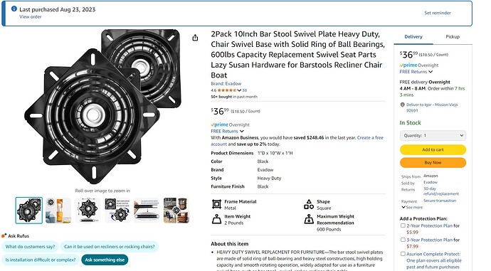

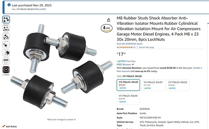

Here is the list of the hardware I used for this build. On top of this items, it was a lot of square tubing and welding, I had a local shop powder coat it for me.
Swivel plates are on the top and bottom and I used this rubber studs to minimize the transfer of vibration from the hardware to the wall.

Buddy has a few Middle Atlantic racks installed in cabinets that hold his AV equipment and some network gear. This model pulls out and swivels:
I've seen this. My stuff is to heavy. LOL

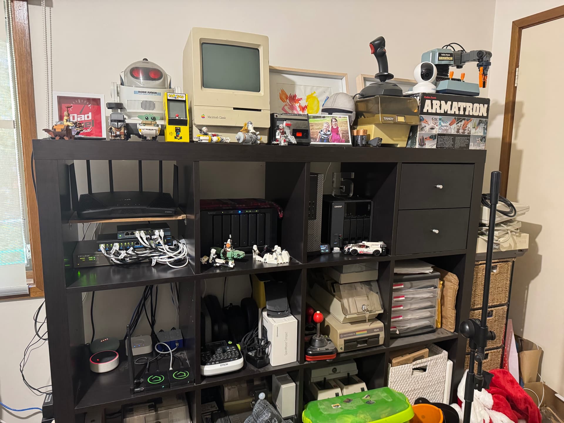

I got a JetKVM the last week for my Plex Server, so I was finally able to retire my Monitor from my study "rack". I backed it on KS, and I'm very impressed with it so far - the quality is great and the team behind it are very responsive to feedback on Discord + GitHub issues.
So I decided to rearrange a few things now that I don't have a Keyboard, mouse and monitor taking up space on the top.
PS, the wife thinks my floor is a dumping ground for old kids stuff and Xmas paraphernalia. :man_facepalming:
