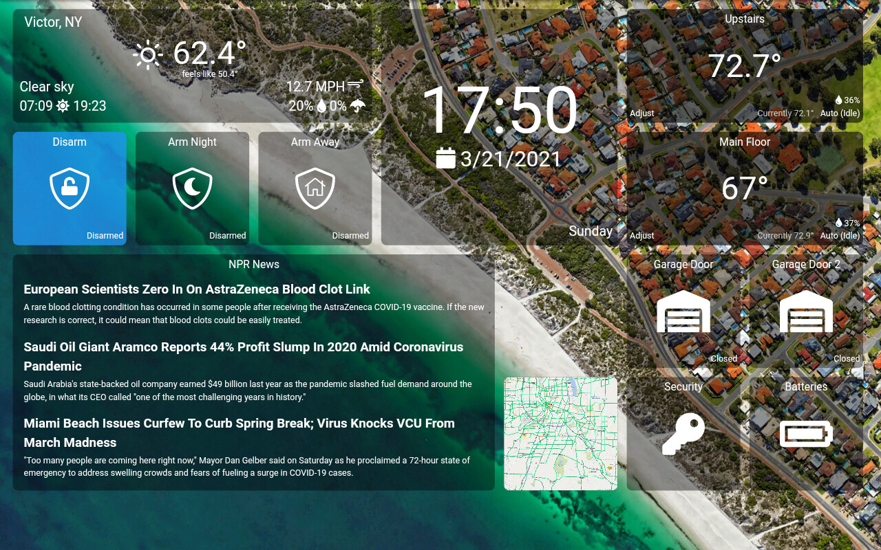

Here's what I've got on Sharptools.io

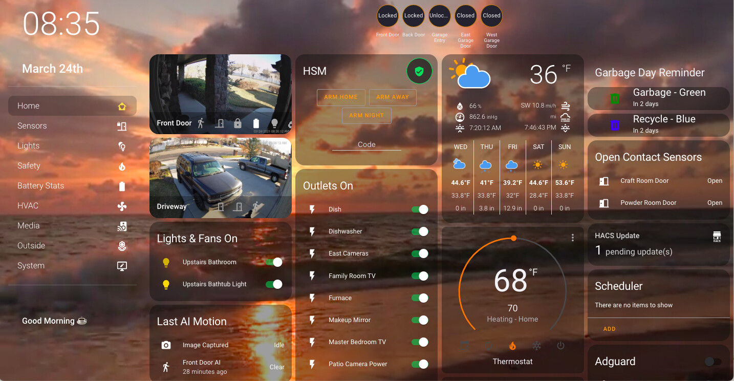

after trying many different solutions(several times!)… I kept coming back to homeassistant for my dashboards….
Hmm, looks like I might need to kick the tires on a HA Dashboard setup. At a high-level, is the idea to integrate HA with Hubitat, and then simply develop the Dashboard there?

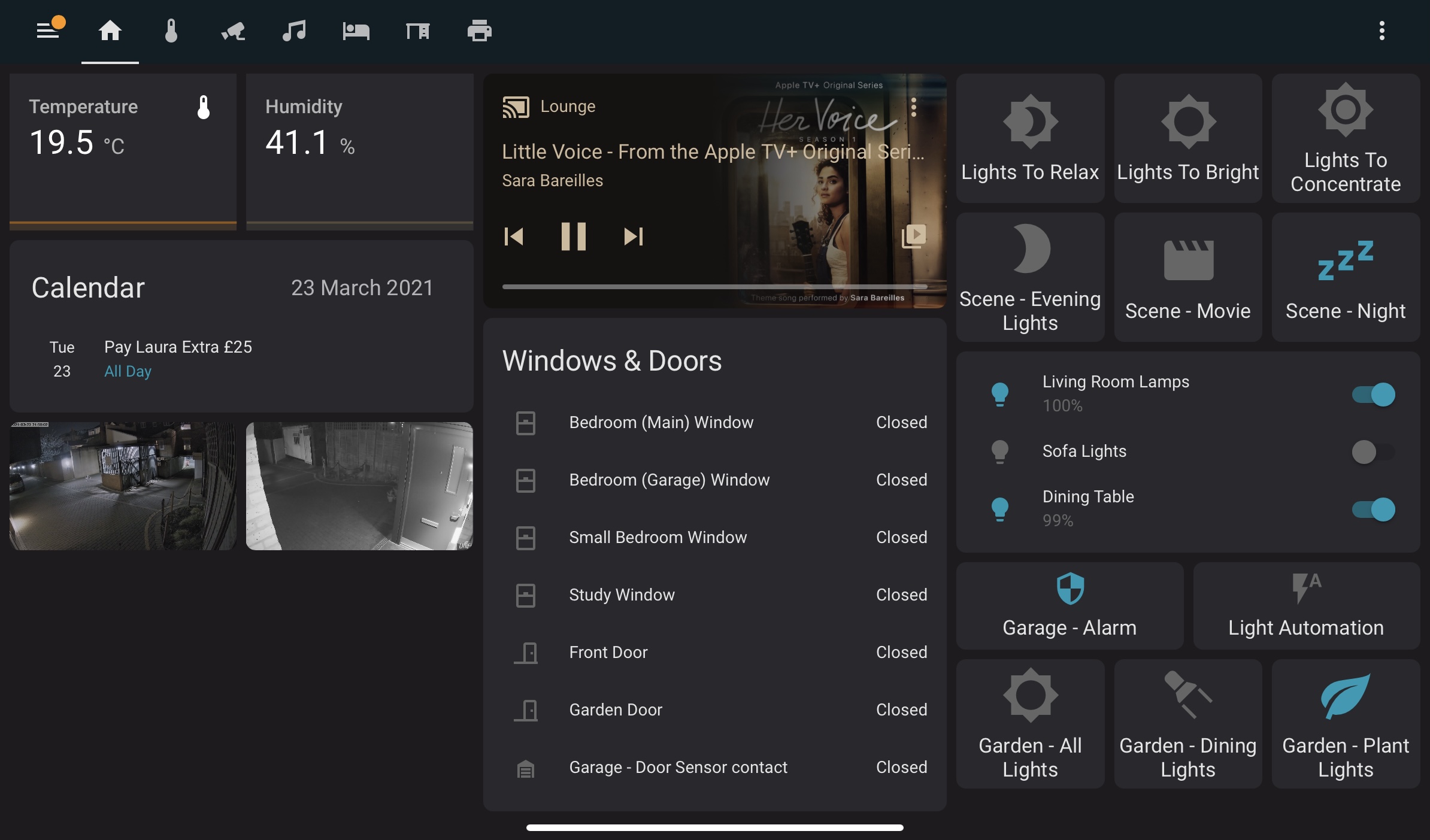

Here's what I've come up with so far -- but I don't love it because of the delays switching between dashboards, etc:
I use HA really only for the dashboards (with Hubitat devices exposed to HA), I keep all my automations on Hubitat. HA is also useful for the occasional oddball integration eg neato vac cleaner or my 3D Printer. I find the HA app also renders the dashboards well on a mobile device. I run HA on an always on Synology NAS in a VM (could also run under docker) - so i’m not maintaining additional kit. There are downsides though, HA has a high tinker requirement, updates can and do break things. Some people swear by HA and it’s certainly got integrations for all manner of stuff, but for me personally, the tinkering looses its novelty the first time something just breaks and youre knee deep in logs trying to find out what broke what..it’s actually one of the reasons I do run it under a VM so I can roll back to a snapshot if something goes wrong..
